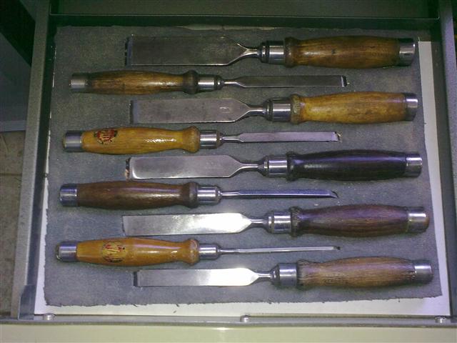

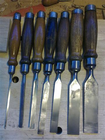

I've got a bunch of titans gleaned from ebay.
They tend to be the ratiest ones as they're the cheapest, but I don't mind spending the time to flatten the backs and re-create the cutting edges (I don't mind the pitting & such on the fronts so I tend to just give them a light clean)

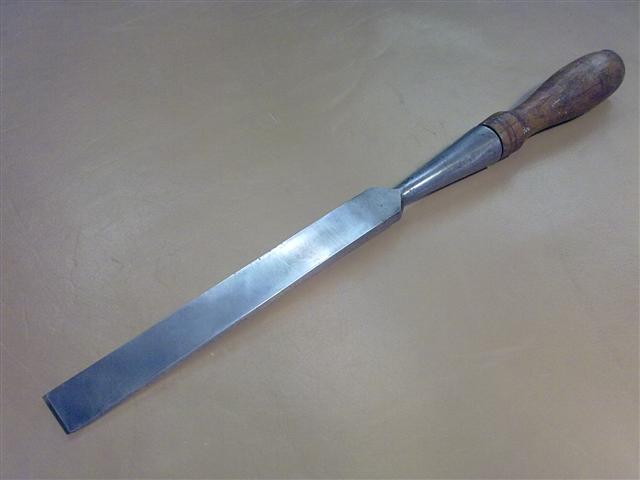

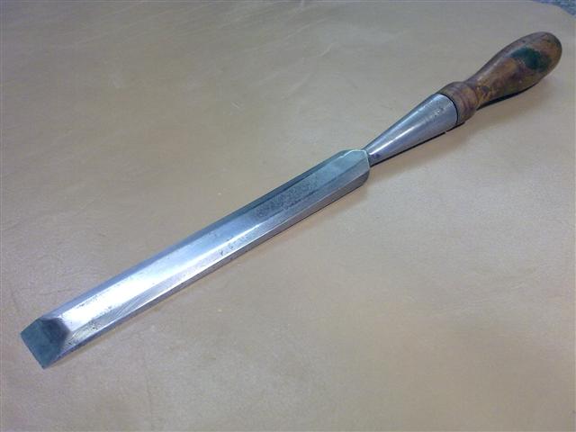

It's a cheaper way to get reasonable chisels, just make sure there's still plenty of length in them. To be honest though, the chisel I use the most (apart from the 1/8 Titan) is a 3/4" Union Hardware set up as per Kim's brace shaving chisel in this thread (don't drool on your screen as you scroll past Michael's chisels
viewtopic.php?f=1&t=2518&p=30832&hilit= ... orn#p30832
I use it on everything, not just for shaving braces, and get's my "Two Thumbs Up"
