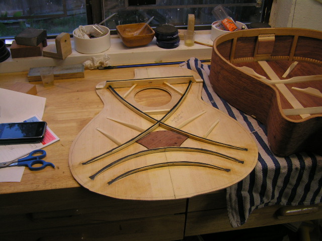

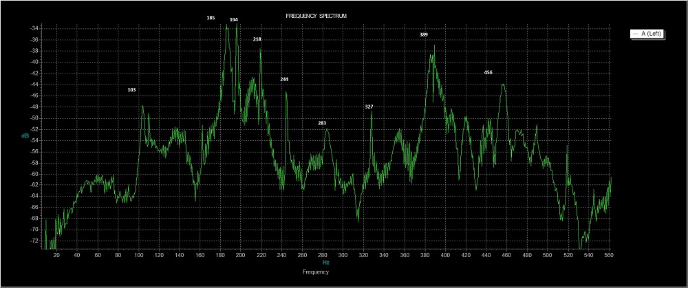

this is a top with bracing inspired by the Gore Gilet books...I will post a pic from my pc shortly, on my laptop at the moment, New to this VA program...

here is the bracing layout

Is this the frequency responce for the finished guitar including the bridge? What type of guitar, steelstring classical? Also the white number are hard to read.

Post by kiwigeo » Mon Sep 03, 2012 6:52 pm
LUKE_LEE wrote:Hi,
Luke
Bridge patch shape suggests its a steel string. Circa 100Hz peak looks like an air resonance peak so this would suggest the top is on the guitar when analysis done.

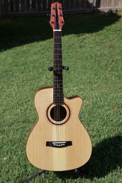

finished steel string guitar, strung up

numbers are 103 , 185, 194 ,218 , 244 , 283, 327 , 389 , 456
Re: Help with analysis
Post by woodrat » Tue Sep 04, 2012 8:55 am
weslewis wrote:numbers are 103 , 185, 194 ,218 , 244 , 283, 327 , 389 , 456
Hi Wes...did you put the side weight attachment points in to trim body resonances? Your 185 needs to go down 5 Hz to start with and side weight is an easy and effective way to do it. I put them in all my guitars now.
