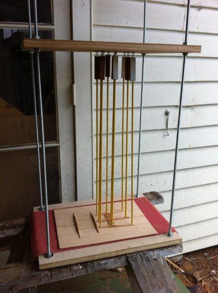

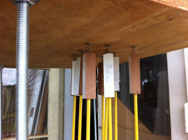

Had a similar problem with fibreglass rods marking the spruce braces and used a bit of native cunning to solve the problem.
Got some cheap rods off Trademe (online auction) for use in a go bar deck. 6mm*600. They provided plenty of force but were a bugger to work with and marked the wood badly. Then I saw another bargain on Trademe a bag of springs - cost $1 and $15 for postage. HUNDREDS of springs about 20mm long and 10mm OD.
Built a cap from cedar 10mm*10mm in section and varying lengths (approx 80mm long). Drilled a 6mm hole in one end to insert the Fibreglass rod and a 10mm depression in the other end for the spring. Secured with hot glue gum. Resulting contraption applies suitable force for gluing and being a vertical force, doesn't have pieces of go bar pinging across the workshop or braces sliding across soundboard.
Am able to make as many more bars as I want just by using wooden rods of a suitable length and mounting the springs on top
Hope that provides inspiration for somebody. If anyone wants springs, give me a yell.

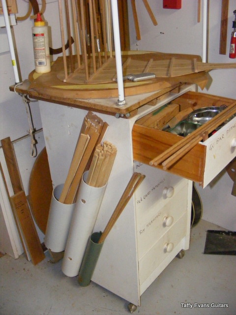

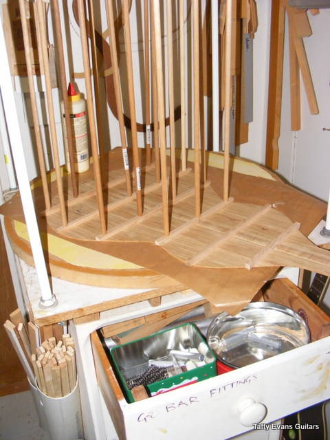

A bit late but I was doing this part of a build and thought I’d show my ideas on using the Go Bar Deck
Mine is mounted on a wheeled cabinet that I pull out if I need to work all around the guitar back, top or the guitar itself if gluing to the rims.
I use shop made rods [three types] of different lengths that suit the job at hand, the top of the deck is fine tuneable for height and a false base can be inserted to further change the distance from top to bottom of the deck.

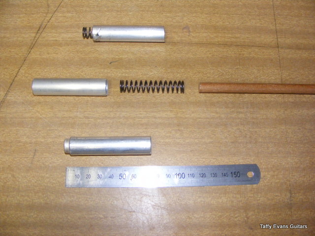

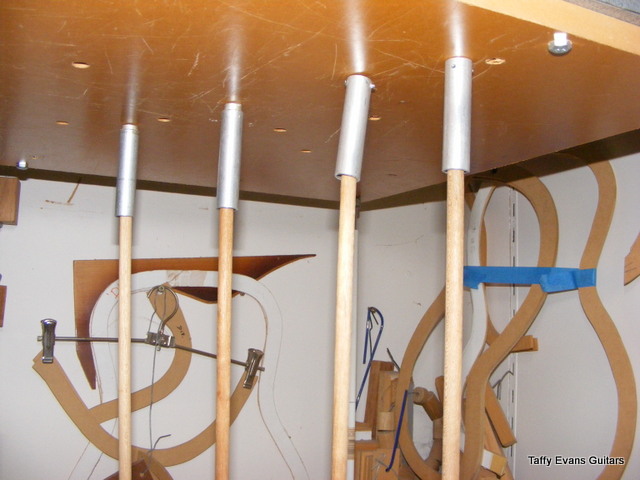

Two of the different rods are cut from a suitable springy timber at two different lengths. The third type of rod I’ve used for the last 15 years or so – the ones used mainly for bracing – are 3/8 dowelling that are spring loaded. These do not mark the bracing.
I used aluminium tube back then but have made some more using plastic covered curtain rod. One type has the spring retained by a split pin at one end that goes through the tube and the coil of the spring, the other has a plug in one end with the spring having electrical tape wrapped around one end to create a push fit. The split pin model does not have the spring sticking out of the end in use, just for this photo.

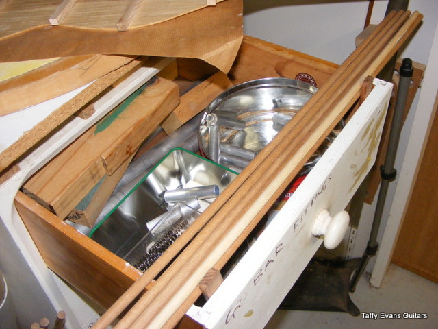

The spring assemblies are in a tray in the open drawer and the rods are lying on top of the drawer, the two are put together as they are placed into position over the brace. All the rods are stored on the side of the mobile go bar deck.
