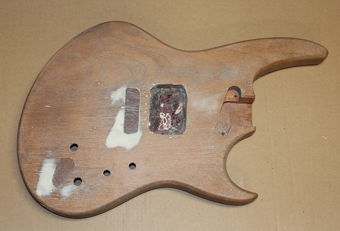

So starting with a hamer guitar

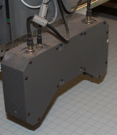

Laser scanners come in all forms / shapes and size. Cost is reflective to accuracy required.
The other side issue is the more accurate you want the scan the less depth of scan can be achieved.
Example if you wanted to scan a building in, then the accuracy would be about 20ft, and depth of scan is probably 100ft
My laser has a depth of field scan of 40mm, beyond 40mm it cannot see it, the accuracy however is 0.005", which is totally unneccassary for woodwork, however I do on occassion scan aircraft parts in for a local business
Laser scanner.jpg (59.53 KiB) Viewed 16358 times

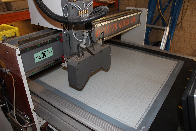

Post by simso » Sun Oct 13, 2013 2:31 pm
You need to mount your laser scanner to a machine, for accuracy we retrofitted a cnc router table to hold the scanner head
You could set it up to flat scan or rotary scan, this is all subject to you the end user
Fitted to a cnc router table.JPG (159.54 KiB) Viewed 16357 times

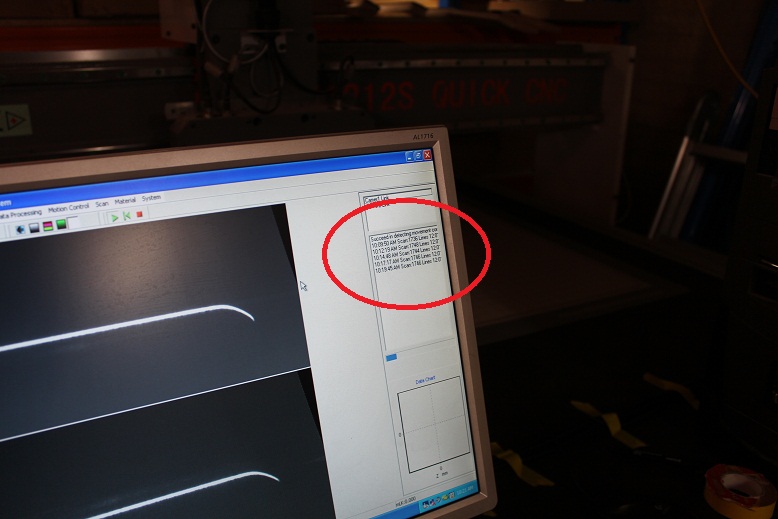

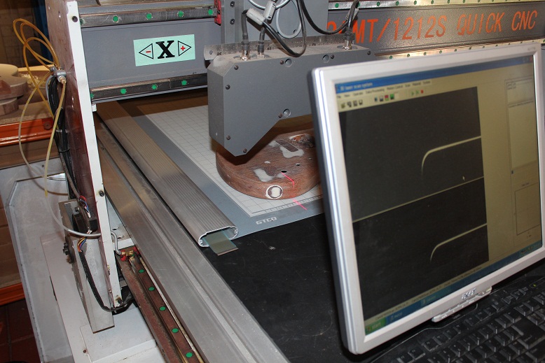

Post by simso » Sun Oct 13, 2013 3:06 pm
In this image, the laser is sitting over the top of the body on the edge, each of the two inbuilt cameras gives a 45 degree resultant image, as shown top and bottom
You can see the guitar is about 50mm, but the laser and cameras only show half the body depth, this is because I focused the top of the job as the centre point of my image on the screen. This means I have 20mm of focus above the job and 20mm of focus below the job
in scan.JPG (159.2 KiB) Viewed 16351 times

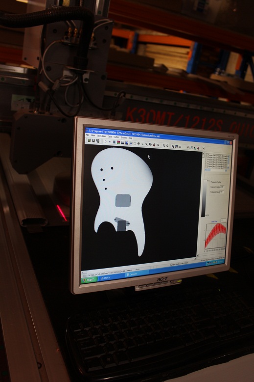

Post by simso » Sun Oct 13, 2013 3:12 pm
At the end of all scanning, you select - stitch, which collates all the individual scan paths, it uses a small amount of overlap from each scan to realign all the strips
This gives you a 3d view of one side of the guitar
one side hamer.JPG (119.66 KiB) Viewed 16351 times

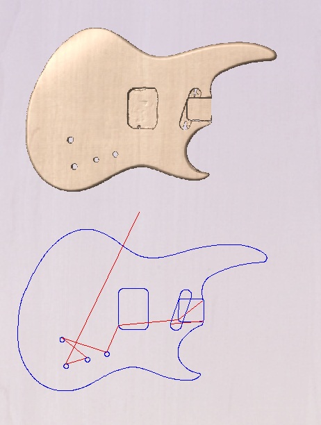

Re: Laser Scanning
Post by simso » Sun Oct 13, 2013 4:59 pm

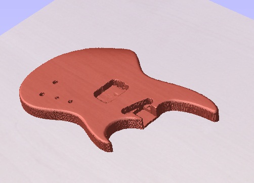

Last but not least, I dont actually end up using the 3d model for all my machining, but I use it as a reference to create vectors for my cnc machine. These vectors I can then tell the machine how deep and how wide I want the cuts at these points, the vectors can also be used for the laser cutter to make an mdf template if you wish to hadn route it out with
And that, is this finished, it can also be done for the opposite side, should you wish
hamer vectorised.JPG (69.87 KiB) Viewed 16334 times
