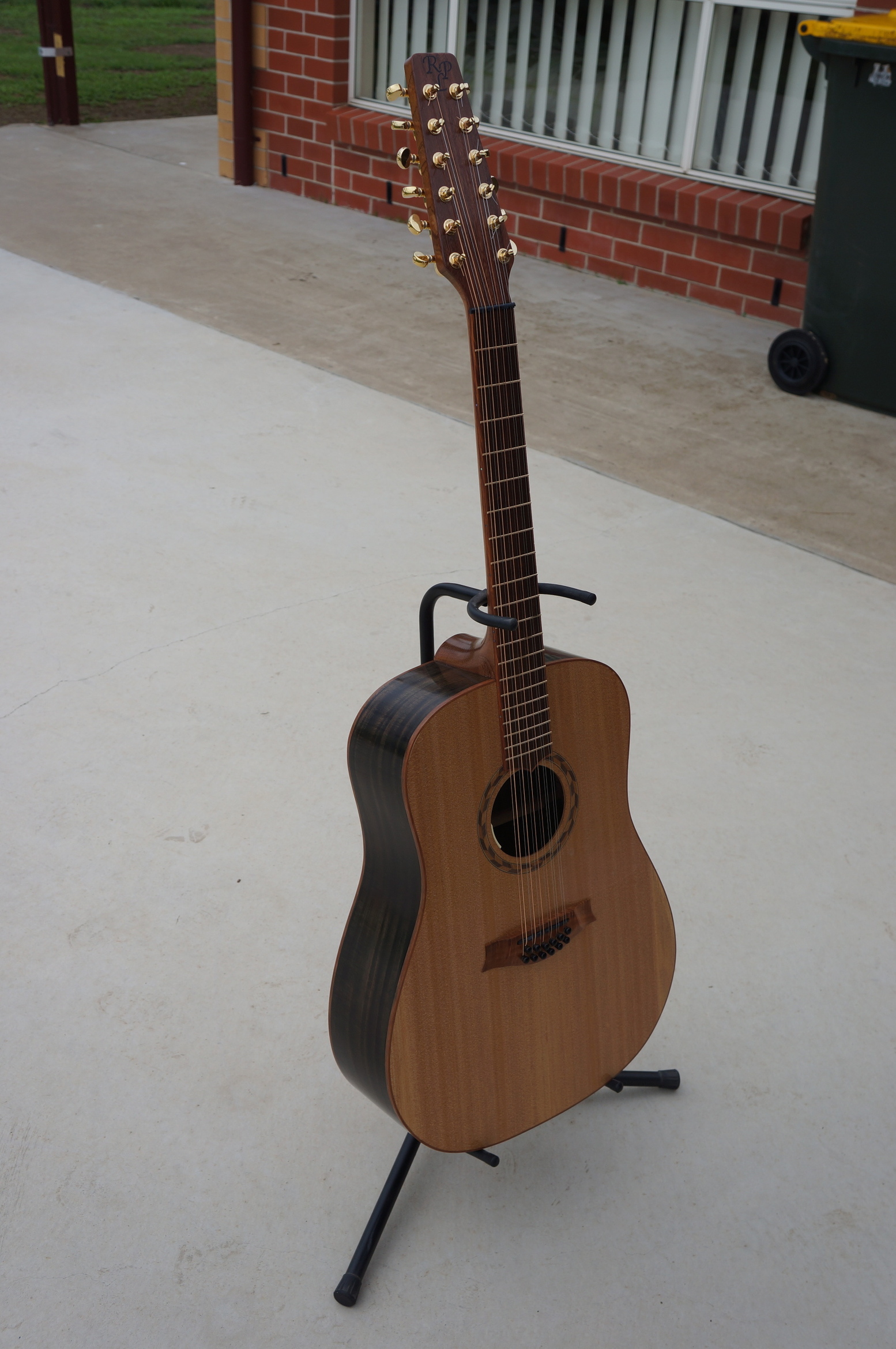

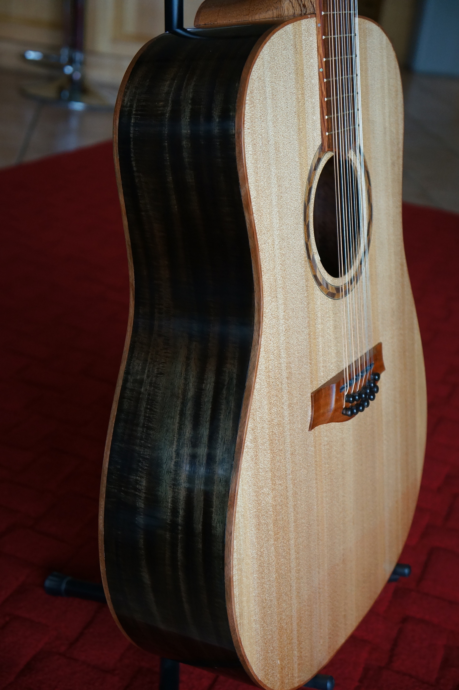

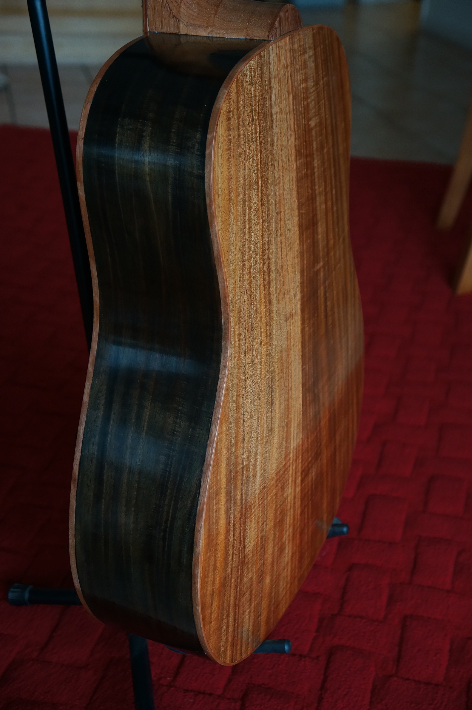

Well, it was a long time to getting finished, but I decided to "dye" the sides black to hide the scorched area but still allow the grain and figure to show through. The end result didn't turn out too bad I thought.
I'll post some more in the gallery soon, but my photographic skills are severely lacking.
Brian

Re: Scorched Sides Advice
Man that's something I would never have thought of....thinking outside the square. This has to be a serious contender for save of the year.
Looks great!
It reminds me bit on those sandwich-like cookies with chocolate
Excellent save, Brian.
How did you do your "dying"?
Hi Trevor,
I used the wood dyes from u Beaut. Basically followed their recommendations. Used a mixture of the Black Green dye and the Red dye, it penetrated very well. They recommend wetting the surface a couple of times to raise the grain and sand smooth before applying the dye to minimise the amount of sanding at the end.
Brian
