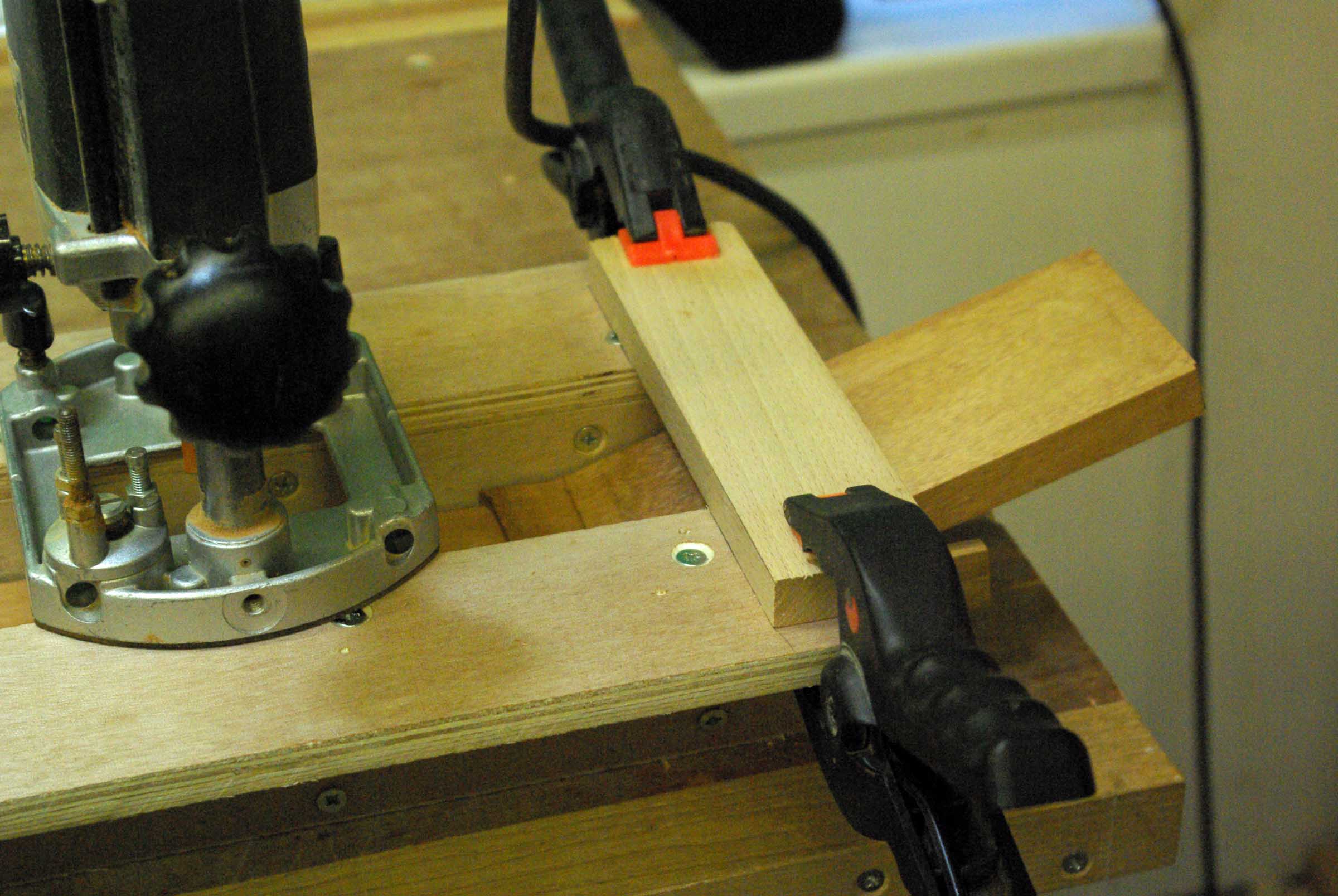

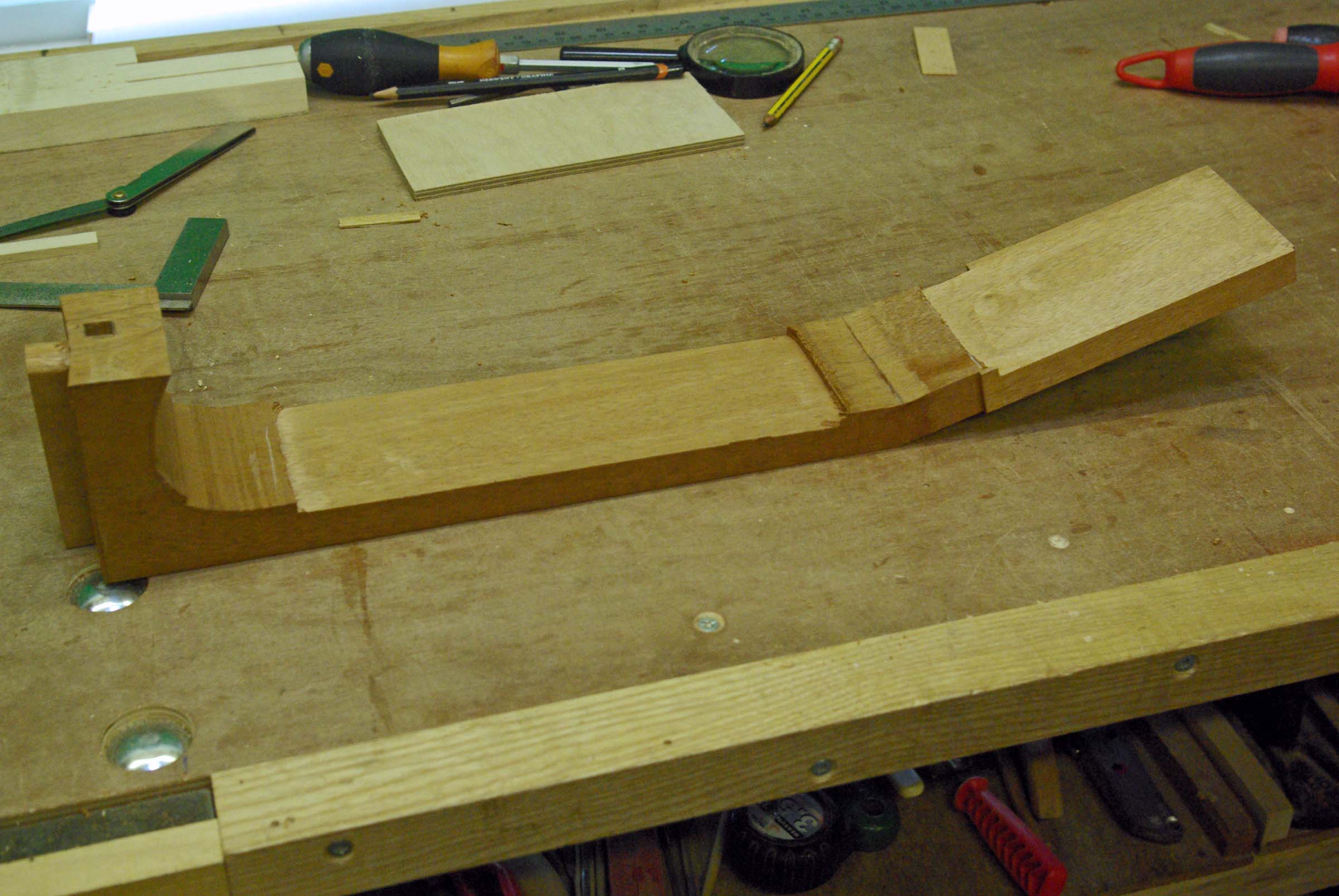

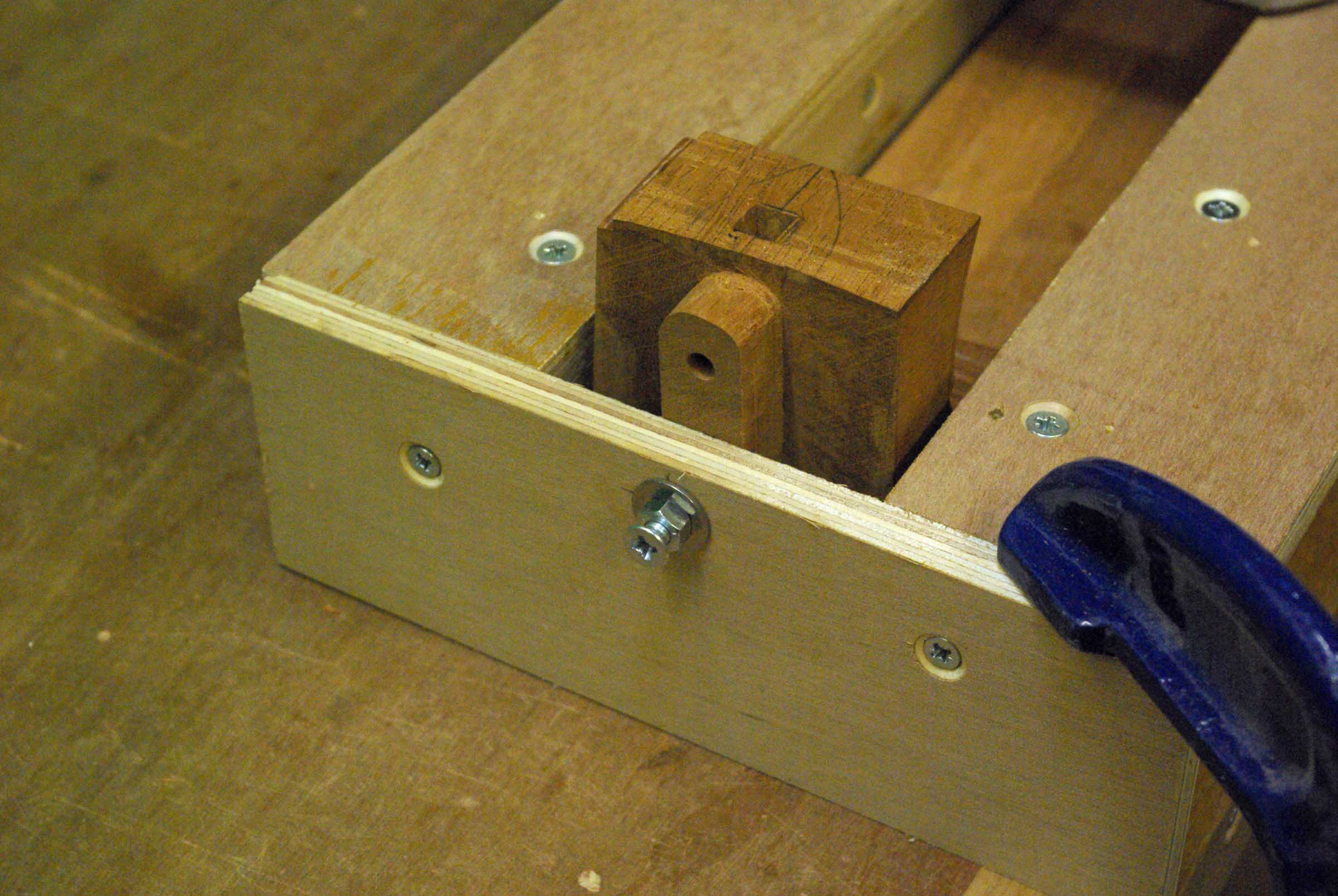

Not having a safety planer I set up a jig to do it with a router. As with G&G I thickness the underside of the neck and the head.
It is essentially a trough with the neck supported at the shallow angle required, with the router running on the top of the trough. The bolt bar in the heel is useful here as in many other operations for fixing the neck. I use wedges to keep the neck fixed against the walls of the box. I do the same thing for the headstock but I haven't shown any pics because the clamping system with wedges and so on is not so satisfactory and I wouldn't recommend the way I currently do it.
Hope the pics show the setup.

Re: neck thickness/headstock thickeness
Post by rocket » Mon Apr 03, 2017 11:37 am
I like it Dave, necessity is the mother of invention, well done.
