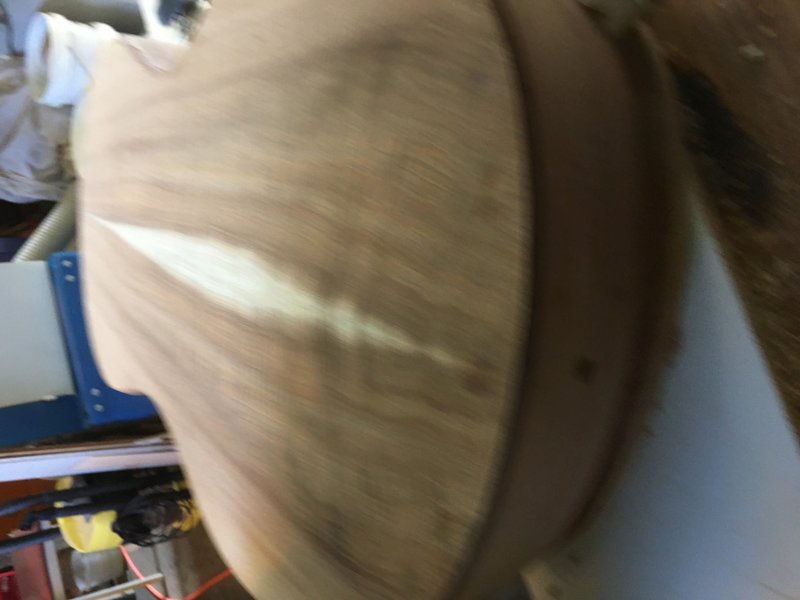

Hi all, has anyone experienced something similar to this?
Closed the box on an archtop recently, Huon pine on Blackwood using HHG but the bloody top didn’t stick very well, on inspection with a thin blade it popped right off, glue adhered to the sides and lining ok but nearly no evidence of glue on the top! I’m thinking the natural oils in the Huon could be the problem, maybe a clean up with scraper and cleaning fluid will be the go?

yep the oils in huon pine can be a real problem.
When i've worked with it i cleaned the surface with acetone 10mins prior to glueing.

Oil in the Huon as noted above. You can try wiping acetone or meths on gluing surfaces if using HHG. I've Titebond fairly good even on oily woods.

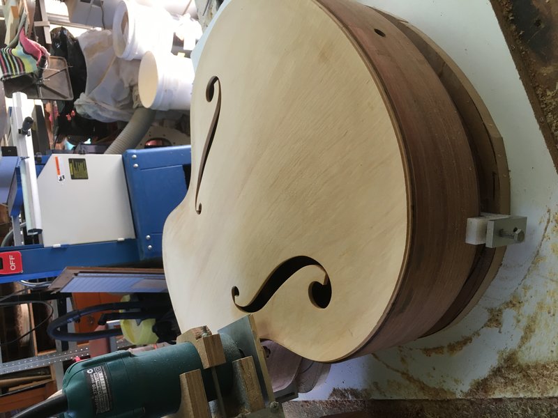

Thanks everyone for your advice I have cleaned all remaining glue from relevant surfaces and wiped down with Shellite and re closed this box using Titebond this time and progressed on to routing binding channels, no sign of the top lifting off this time.
