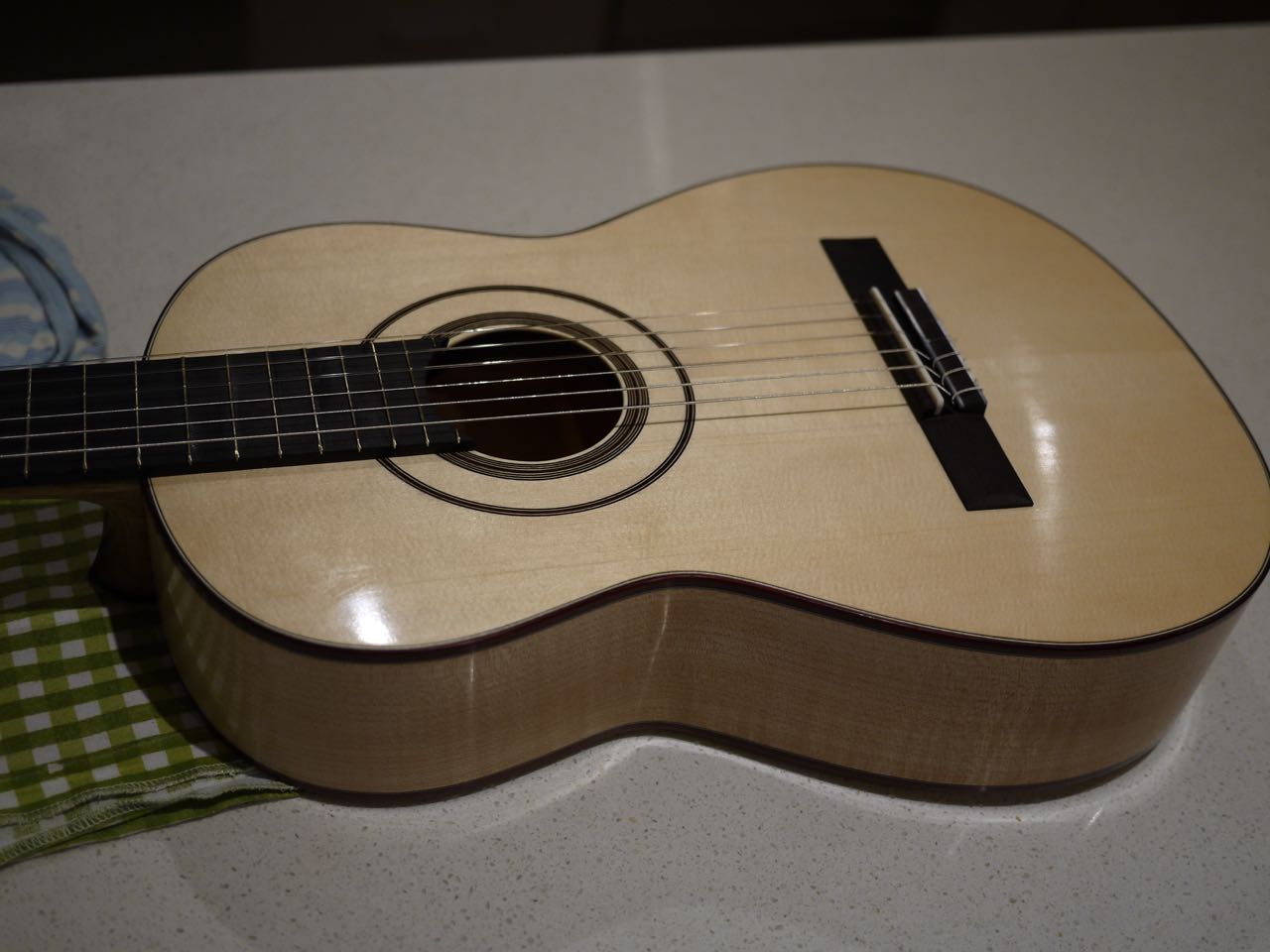

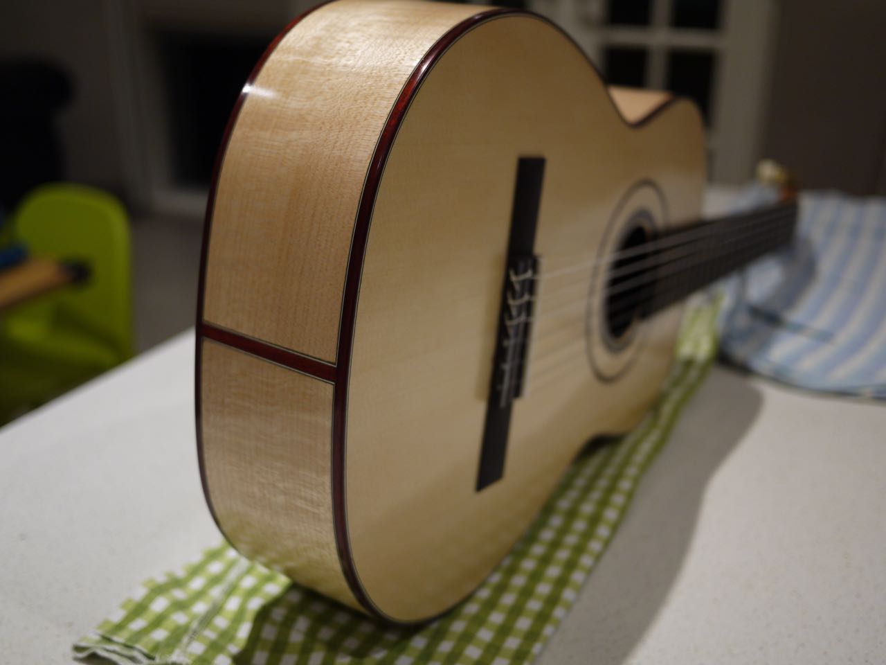

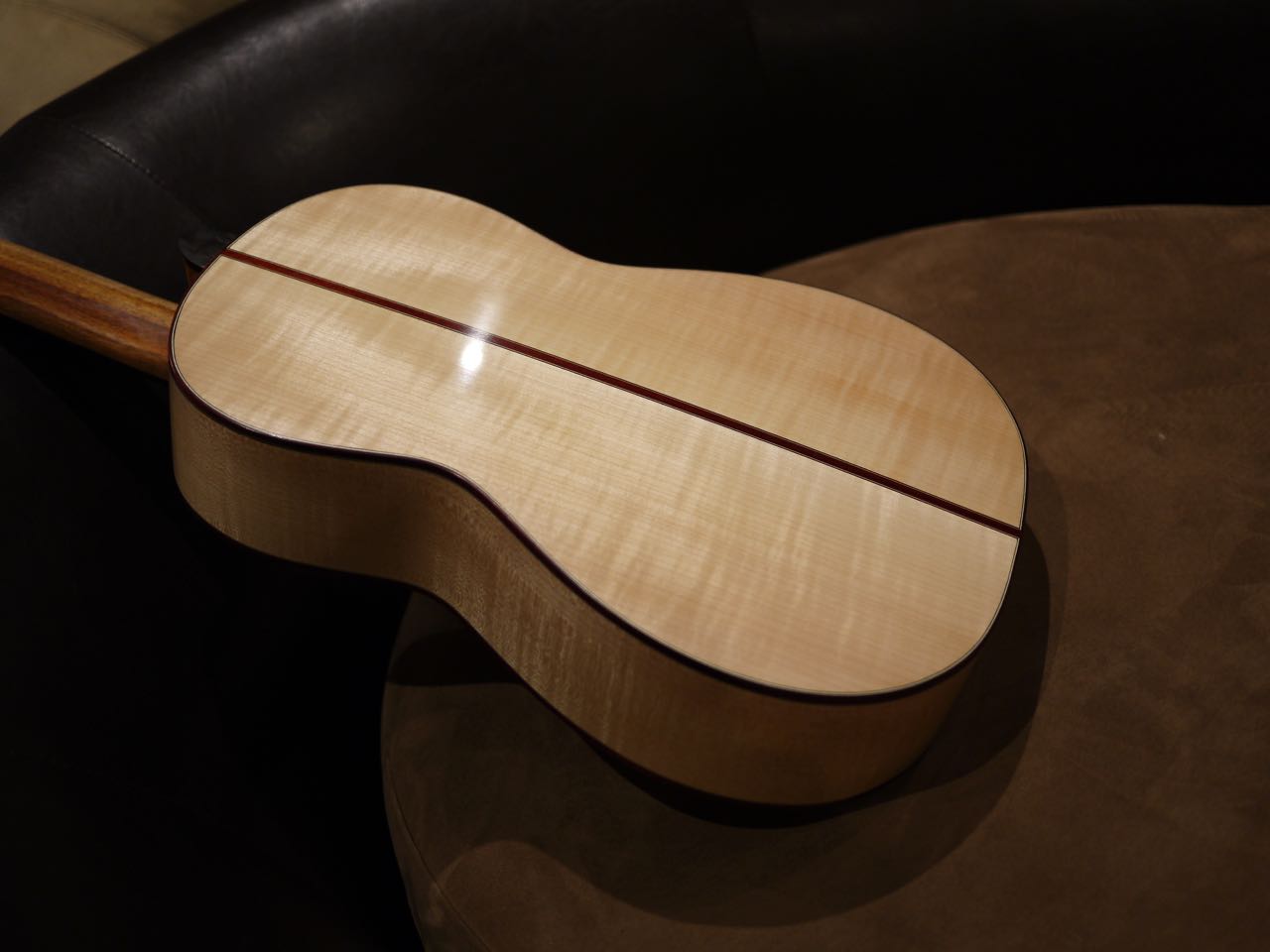

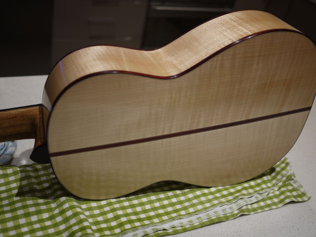

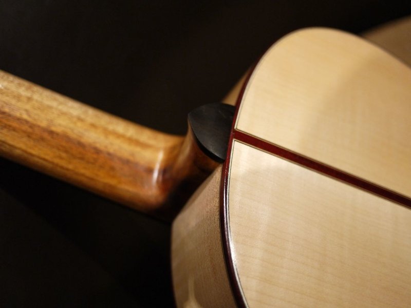

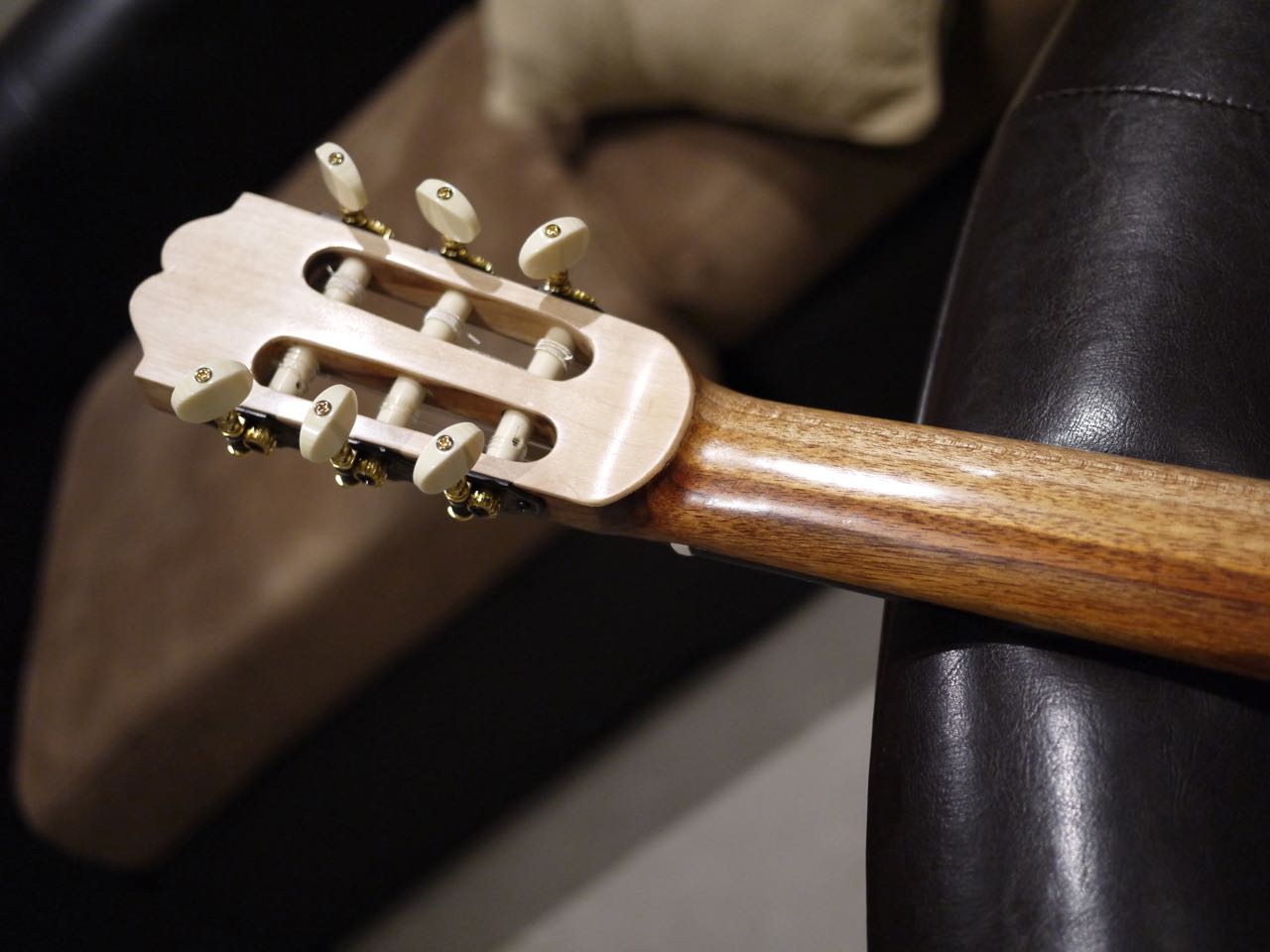

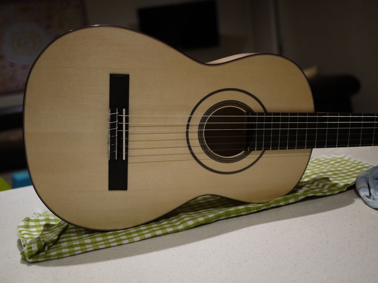

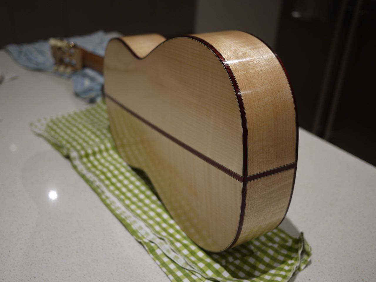

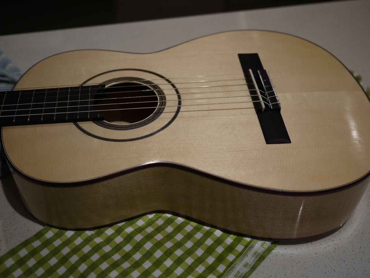

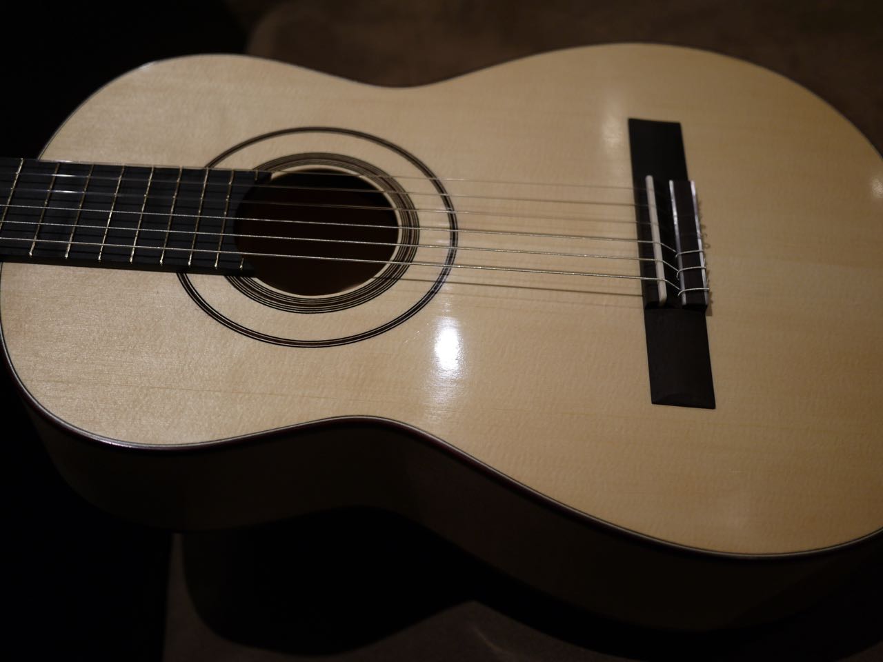

Strung up my latest build tonight....
Maple/spruce 1864 Torres “inspired" classical guitar, including a mini tornavoz. I really like maple.

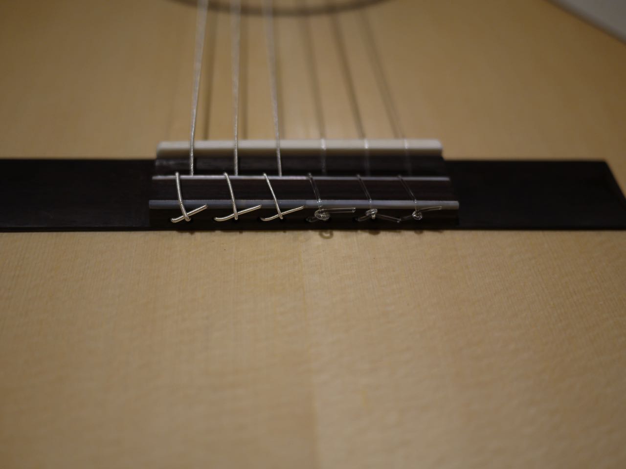

Slightly shorter scale length - 636mm rather than the standard 650 and a 12 hole tie bridge. Bloodwood bindings, stripey blackwood bolt on neck with a truss rod.
I’m happy with the sound - as good if not better than the last one (same dimensions and bracing but rosewood/spruce). I like how these smaller classicals are turning out so the next build will be the same shape in Australian blackwood and either spruce or cedar.
