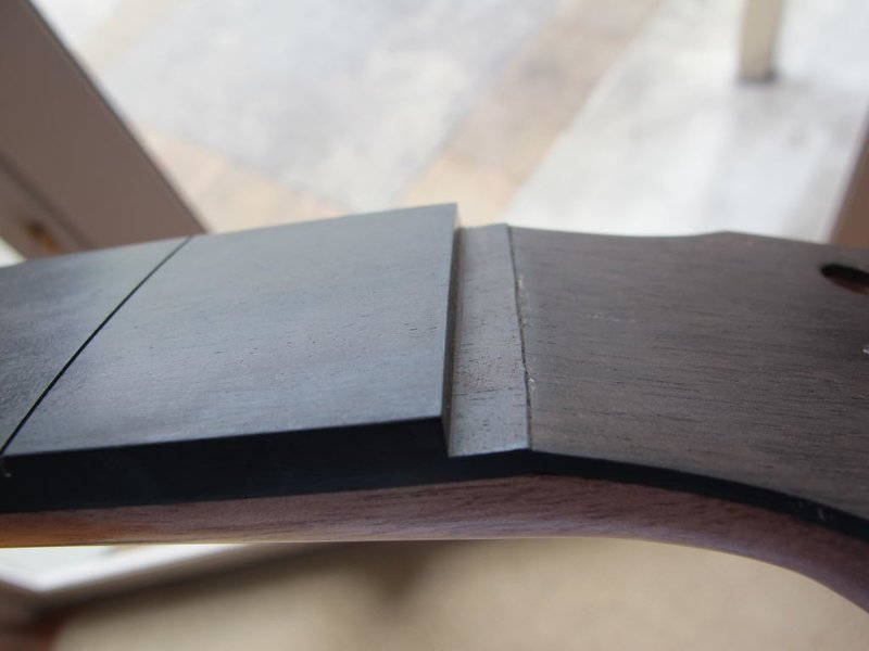

Hi again. I have done something a bit dumb, planing the peg head veneer to get the correct 15 mm overall thickness resulting in a ledge rather then a recess for the nut, if that makes sense. Does the nut need to sit in a pocket or can it sit on a ledge with some epoxy holding it? Other option is I can cut the ledge off the fretboard and chisel down to the neck wood, just runs the risk of an untidy job.
What would you recommend?
Thanks

I suppose another alternative is a nicely shaped 3 mm thick ebony fillet glued behind the nut?

Post by Trevor Gore » Sun Jan 06, 2019 10:37 am
The simple option is to do nothing. Once strung up the nut will sit there quite happily. A single drop of superglue could be used to prevent it dropping out whilst stringing.
If you want to retain a channel, the challenge is keeping the bottom of the slot flat. Whatever you do, don't remove all the thickness of the ledge on the fretboard, because you will almost certainly end up with the bottom of the nut slot below the level of the fretboard, which is not a good look. If you go this route, a flush cut saw and a narrow chisel is the way to go. Always cut from the edges inward to avoid chip-out. A custom made sanding stick matching the width of the slot will help you level the bottom if it proves too difficult using just the chisel. It's always hard to match the accuracy of the routed ledge, though.

You could just slap on another layer of veneer on the peghead. Drill through tuner holes from back side with a brad tip bit till tip just penetrates the upper surface of the new veneer and use this hole as a guide for the same bit drilling through from upper side of veneer.

Post by Richardl » Sun Jan 06, 2019 2:04 pm
Thanks guys. Doing nothing is my preferred option :D . I have some fancy paua inlay in the peghead so cant really add another full layer on top.

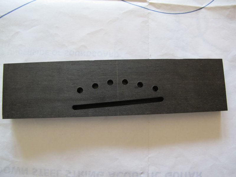

I've been working on the bridge today. Opted for the traditional compensation route. Unfortunately I have routed the saddle rebate a bit wide for the 1/8" bone saddle I have (don't know how) and I only left 2 mm in the bottom thinking that would be enough. I can't for the life of me find a reference to the depth of this router cut so checked with Kinkead which says leave 3 mm - should have checked first!!
So the bridge is currently 10 mm thick and the slot is 8 mm deep. Is that sufficient meat in the bottom? Making another is fairly easy (apart from getting the wood) as I have made all the jigs now.
The other thing is, the low E string is, due to the arrangement of the drill holes, going to be quite close to the saddle. Is that OK, won't pull the pins out will it? If the bridge was 5 mm thick as stated in the book, it would be very close

Post by Trevor Gore » Sat Jan 12, 2019 11:06 am
I can't for the life of me find a reference to the depth of this router cut...
Section 20.3.2, penultimate paragraph.
I wouldn't be worrying about it.
The other thing is, the low E string is, due to the arrangement of the drill holes, going to be quite close to the saddle. Is that OK, won't pull the pins out will it? If the bridge (saddle??) was 5 mm thick as stated in the book, it would be very close
In the book, the saddle isn't slanted (due to nut compensation), so not as close as you might think. The pins are unlikely to pull out, but with the 6th string hole that close to the saddle you'll get an upward curve of the string due to its bending stiffness making the action harder to predict. Pressing down on the string to kink it over the saddle seems to knacker the string and it loses a lot of response IME. I'd be making a new bridge for that reason.

OK, thanks, so better to have the pins in a straight line if no nut compensation, I thought there was mention of a slanted saddle. Sorry, somehow missed the 6.5 mm deep slot. Yes, saddle not bridge. I'll make a new one.

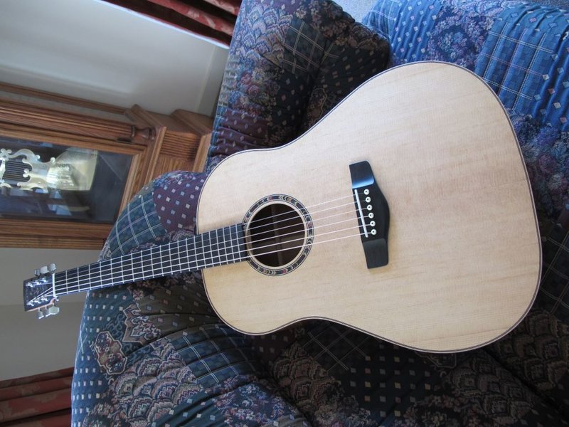

Post by Richardl » Sat Feb 02, 2019 5:14 pm
Finally finished. Far from perfect but it's only number 2 so I'm pretty happy. Sounds good. That's the main thing. Thanks for all the help.
Posts: 10897
Re: Bolt on bolt off neck - order of operations
Post by kiwigeo » Sat Feb 02, 2019 8:48 pm
Nice work Richard. These Gore builds can be a challenge at times (my last one took 2 years) but when they're done its well worth the extra effort and you learn a whole lot in the process.
