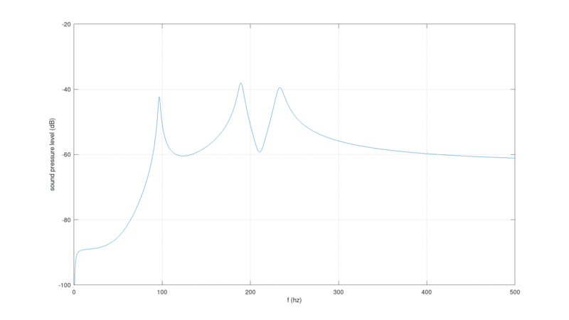

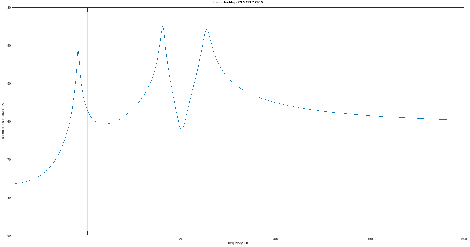

I'd like to collect here in this thread any mathematical models people have made using the four-degree-of-freedom equations. This would be composed of input values and calculated results, having been measured from and/or fit to real guitars, as shown on page 2-37 of the design book.
Unfortunately, as far as I know, there is only one such set of values in the world, on page 2-37, which is a nylon-stringed classical. I'm hoping we can collect more, maybe get some steel-stringed guitars as well. This would help folks (OK, me) design other similar guitars, starting with these as references. I'd especially like to see values for the Medium falcate-braced, live-back, steel-string guitar as built in the book.
I've started a spreadsheet of such models, one per column. If I can collect several such models, I could share it on the Internet as a Google Sheet.

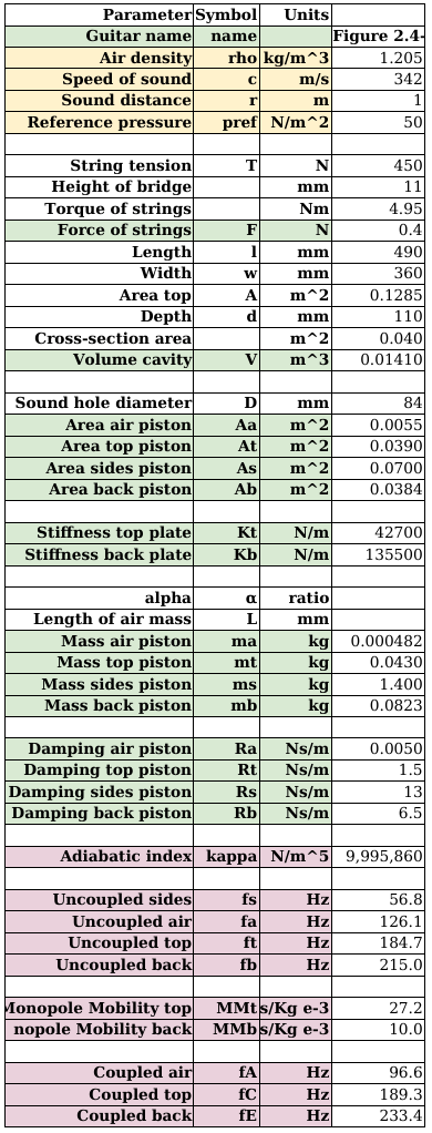

So that I can iterate on the parameters faster, I've taken the Octave/MATLAB script posted by Jim Kirby here, and used Octave functions to read the parameters from the spreadsheet file, calculate all the guitar models it finds there, and update the results back into the file. I do this on Linux using the LibreOffice spreadsheet software, and I have also written a LibreOffice BASIC macro to automate this with one click in the toolbar.
I entered the data from the book into the spreadsheet, and got nearly identical results, including the plot (although I note that the coupled back frequency, fE, has a little higher dB level than in the book).
Yellow rows are physical constants, green rows are inputs, red rows are calculated results.
I've also made a few small improvements to the Octave script, as you can see in the spreadsheet above:
1. I calculate the four frequencies of the uncoupled "springs": air, top, sides, and back.
2. I calculate the monopole mobility of the top and back.
3. Using the Octave "signal" package, I find the three peaks of the coupled frequencies. This is so you con't have to zoom in on the plot and try to estimate the values.
I will share this Octave script soon. I think it needs some more testing. It should in theory work on Windows and Excel, but I don't have those to test on. There are also some bugs in the Octave "io" library (reads and writes spreadsheet files) that I'm working with the library developer on. I'm a little hesitant to post it, since setting it up involves installing a lot of stuff (Octave, three Octave packages, Java, and some Java libraries). I'm not sure I want to take on the task of supporting people getting all that working.
In the mean time, does anyone have any model values tuned to real guitars that they'd like to share?

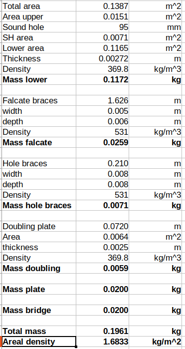

Surely someone out there knows the mass of the top on the falcate-braced medium steel-string?
Well, in any case, I've attempted to estimate the mass by adding up all the parts, and using their dimensions and density. Here's what I got:
This is just for the vibrating area below the transverse brace. I calculated the areas by counting squares on the drawing, not including the head and tail blocks.
So, 196.1 grams for the structure below the transverse brace, or 1.68 kg/m^2.
This seems about right. With an area for the top piston of 0.0415 m^2, that gives a mass of the top piston of 0.0698, which agrees with the quote from the book (see previous posting).
So that's what I will use in modeling the falcate-braced medium steel-string.

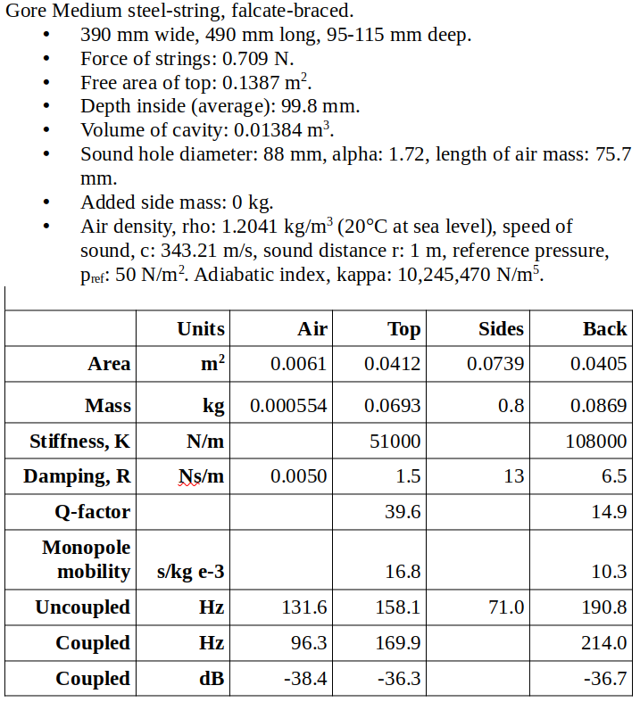

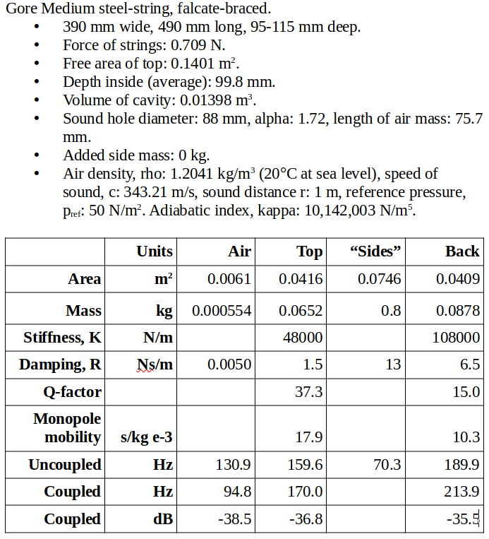

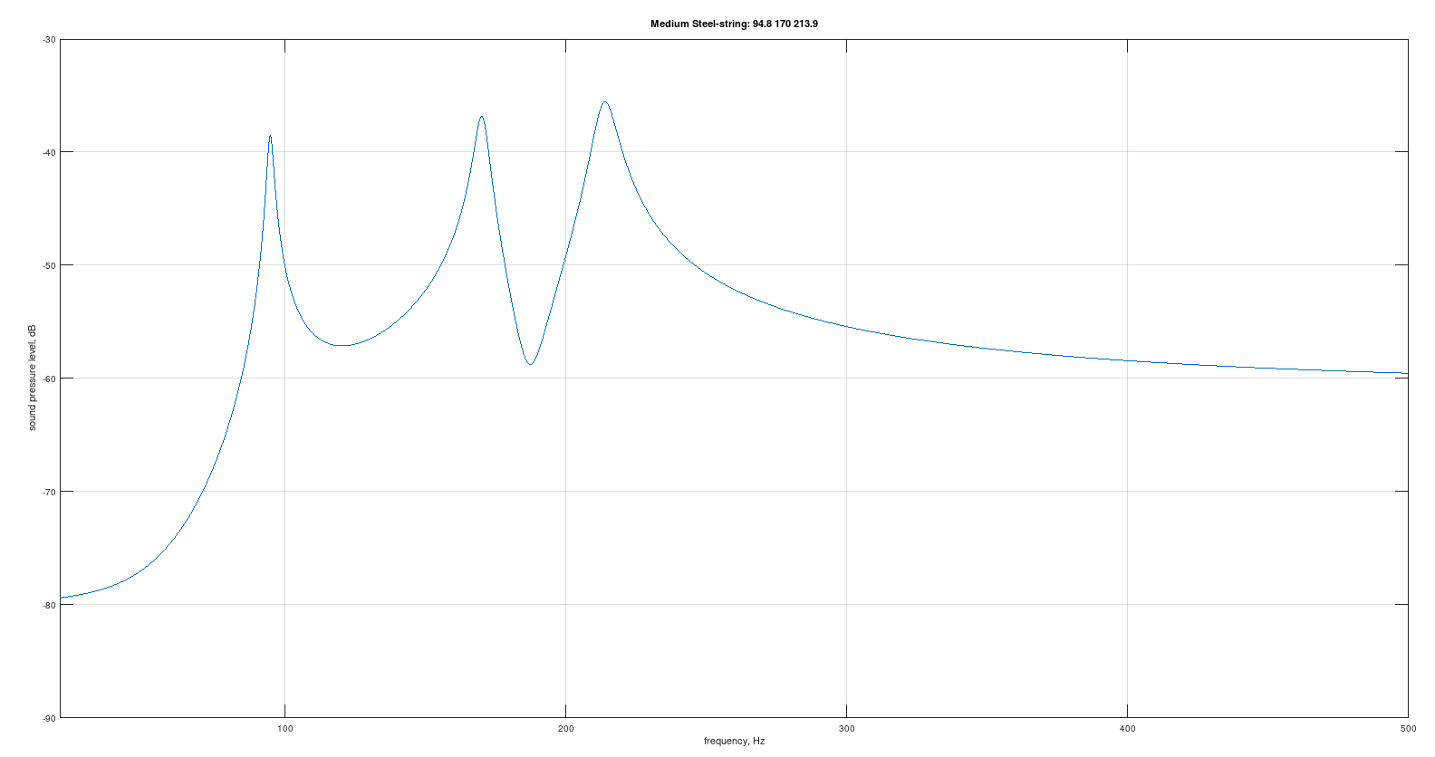

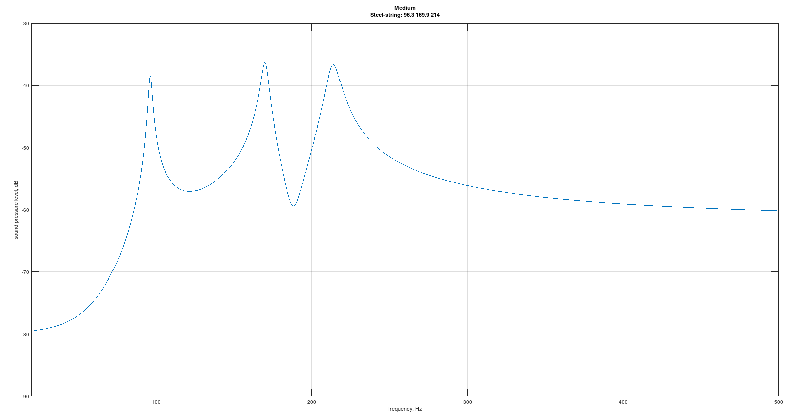

OK, my best guess for modeling the Gore Medium steel-string:
If you want to see how I came up with these numbers, here's the spreadsheet.
My technique is: I start by estimating the areas and masses by counting squares on the drawing, or making proportional calculations. I have no idea how to estimate the damping values, I just used the ones from the book. I tested these estimating techniques by using them on the nylon-string classical guitar in Fig 2.4-4, and it came out very close to the same.
Then I play with four parameters until I match the target coupled frequencies: sound hole diameter, stiffness top plate, stiffness back plate, added side mass.
I initially set the sound hole diameter to the design size (95 mm), and the stiffnesses to give monopole mobilities of 18 and 9, and added side mass to 0.
Then I select one of the sets of target coupled frequencies that the book recommends, and adjust the four parameters trying to get close to the target frequencies. Sometimes I have to change the targets if I can't get there and another target looks closer.
In this case, I ended up with targets frequencies of 95/170/214, and I was able to get pretty close to those.
My four parameters ended at: sound hole = 88 mm, Ktop = 51000, Kback = 108000, added side mass = 0.
Does anyone have real numbers for this guitar?

Re: Collecting 4DOF models
Length and width for my OM sized steel string guitars are 482mm x 382mm.

Re: Soundboard mass and area
I have added to my spreadsheet an estimate of the whole soundboard mass of a medium steel-string with cut-away (per drawing #4), including the transverse brace, and head and tail block areas.
I came up with 238 g. Pretty close the the numbers others have given here (229, 230, 239).
For an area of 0.144215, that's an areal density of 1.65 kg/m^3. Close to other numbers given here of 1.72, 1.65, 1.59. That gives me confidence.
I also improved my estimate for just the vibrating portion below the transverse brace. I got 198 g for an area of 0.1260, and so an areal density of 1.57.

Re: Updated model for the medium steel-string
I used the new 1.57 kg/m^2 number to update my 4DOF model of the medium falcate-braced steel-string.
Based on the classical in table 2.4-1, the area inside the Chladni line (i.e. the top effective piston) is about 30% of the free top area, so I'm using At = 0.0416 m^2 (compared to 0.039 for the slightly smaller classical).
Similarly, about 53% of the top becomes the outer piston (aka the "sides"--terrible name!), so As = 0.0746 m^2.
As described above, I use target frequencies of 95.2, 169.7, and 213.8 Hz, and adjust sound hole diameter, stiffness of the top and back, and added side mass.
I found that D = 88 mm, Kt = 48000 and Kb = 108000 N/m, and no added side mass gave me frequencies of 94.8, 170.0, and 213.9 Hz. Pretty close. Monopole mobility for the top and back of 17.9 and 10.3.
Not much changed due to the updated top mass. The biggest change was Kt went from 51000 to 48000.
I'm still hoping that someone who has actually built this guitar can give me real measured numbers for Kt and Kb.
Also, any insights on how to set the damping values (Ra, Rt, Rs, Rb) would be helpful.
Next, I will try to model an archtop. I want to figure out target frequencies, and top and back stiffness (Kt, Kb) and sound hole area, and see if I can maintain good monopole mobilities. Archtops are usually not nearly as deep as acoustics (75 vs 115 mm), so things could get interesting!
Greg
Reminder: all this data is in the spreadsheet.

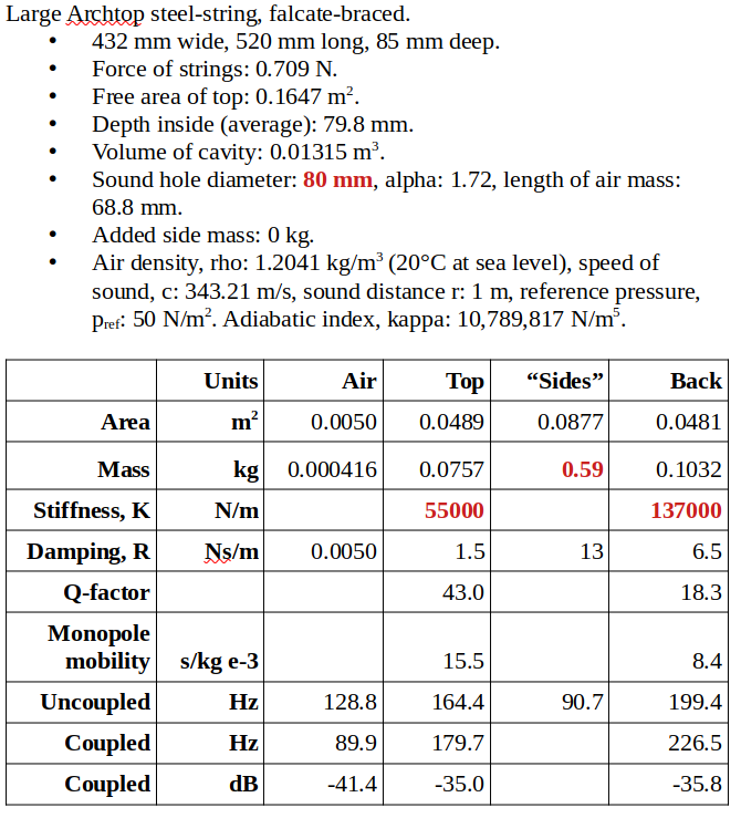

Re: Large Archtop
OK, I've modeled a large acoustic archtop, 17" x 3.3". Pretty close to a Gibson L-5.
I came up with an 80 mm sound hole, top stiffness 55,000 N/m, back stiffness 137,000, no added side mass, producing resonant frequencies of 90, 180, and 227 Hz.
This gives me targets for the cylindrical archtop I want to build.
Let me know if anything looks unreasonable.
As usual, all the models are in this spreadsheet.
Greg
