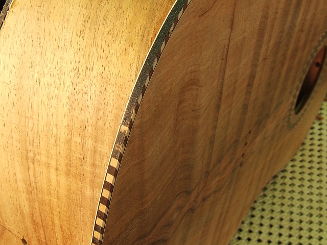

Top bindings glued in. Bindings plus purfs on bottom of bindings and two purfs behind the bindings all installed in one go.....call me Mr Octopus!
The Luthier Tools binding cutting jig in the first photo....I've tried the other binding cutting jigs but Im just most comfortable with the Luthier Tools and the Porter Cable trimmer....it's something to to do with the fact I'm moving the trimmer around the guitar rather than moving the guitar around a stationary trimmer. Horses for courses...
Re: Current Build - Falcate Braced Multiscale OM cutaway
Back bindings in and the back scraped back. Had a few minor gaps that got filled by rubbing in ebony dust and then wicking in low viscosity CA glue.
