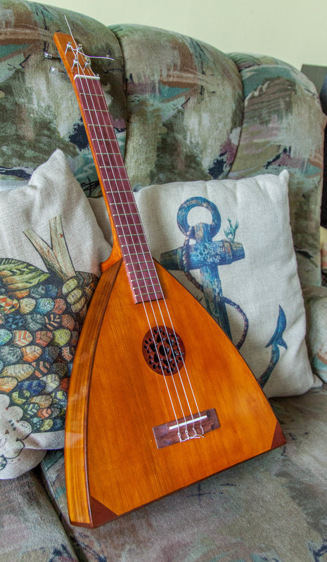

Here's mine, which I have only just finished last Week.
Mahogany Neck / Cedar Sides, SoundBoard & Back / PurpleHeart FretBoard & Bridge / Aquila Baritone Strings / Bone Nut & Saddle / Mahogany Binding & Rosette / Piezo Pickup / Shellac Finish

Nice
A balalika next?

I don't want to hijack the OP's Thread, but each and every Instrument I have made, (this is #17), has something different that I haven't done before, just to push my Skill-Set further. First one as a Balalaika, and first Classical Style Bridge.

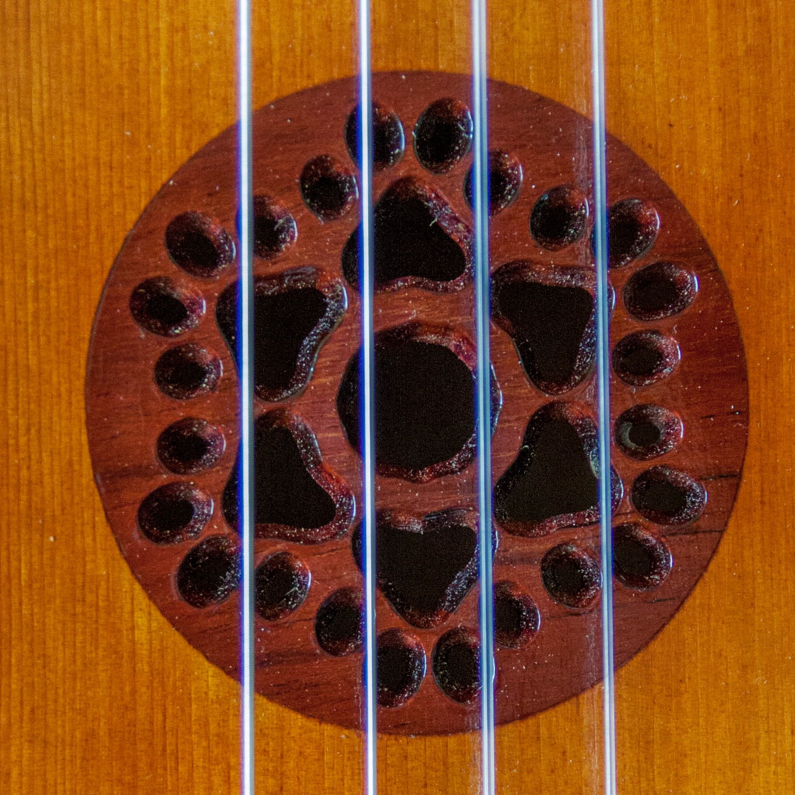

Rosette is attached, let me know if you see what the pattern is ...
Body shape gives it a very loud volume, equal to my Classical Guitars. Body is 300mm high, 65mm deep, and 300mm across the Butt.

Thanks for the pic Murray. Its paw prints, the question is canine or feline. I'm going to go with man's best friend. Which of the many cedars did you use? I'm not sure if any of the local cedars are hard enough to consider using. What I've come across will dent if you look at them hard.

Forgive my ignorance if I have this wrong, I thought balalikas only had 3 strings and what you built is a hybrid.
A balalele maybe
It looks good though - deserves it own thread.

The Instrument is a Baritone Ukulele with a Soundbox shaped like a Balalaika and tuned D3G3B3E4 as per a Baritone Uke.
Balalele or Ukulaika ... your choice ...
