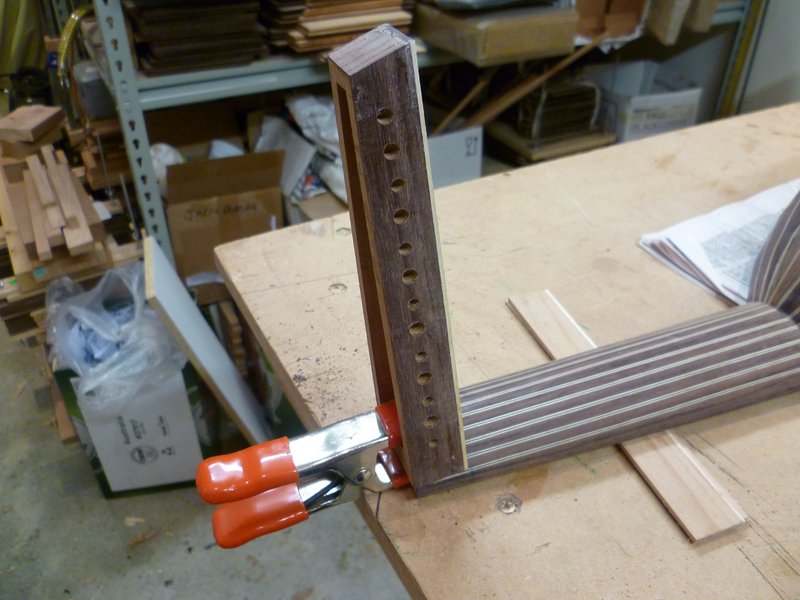

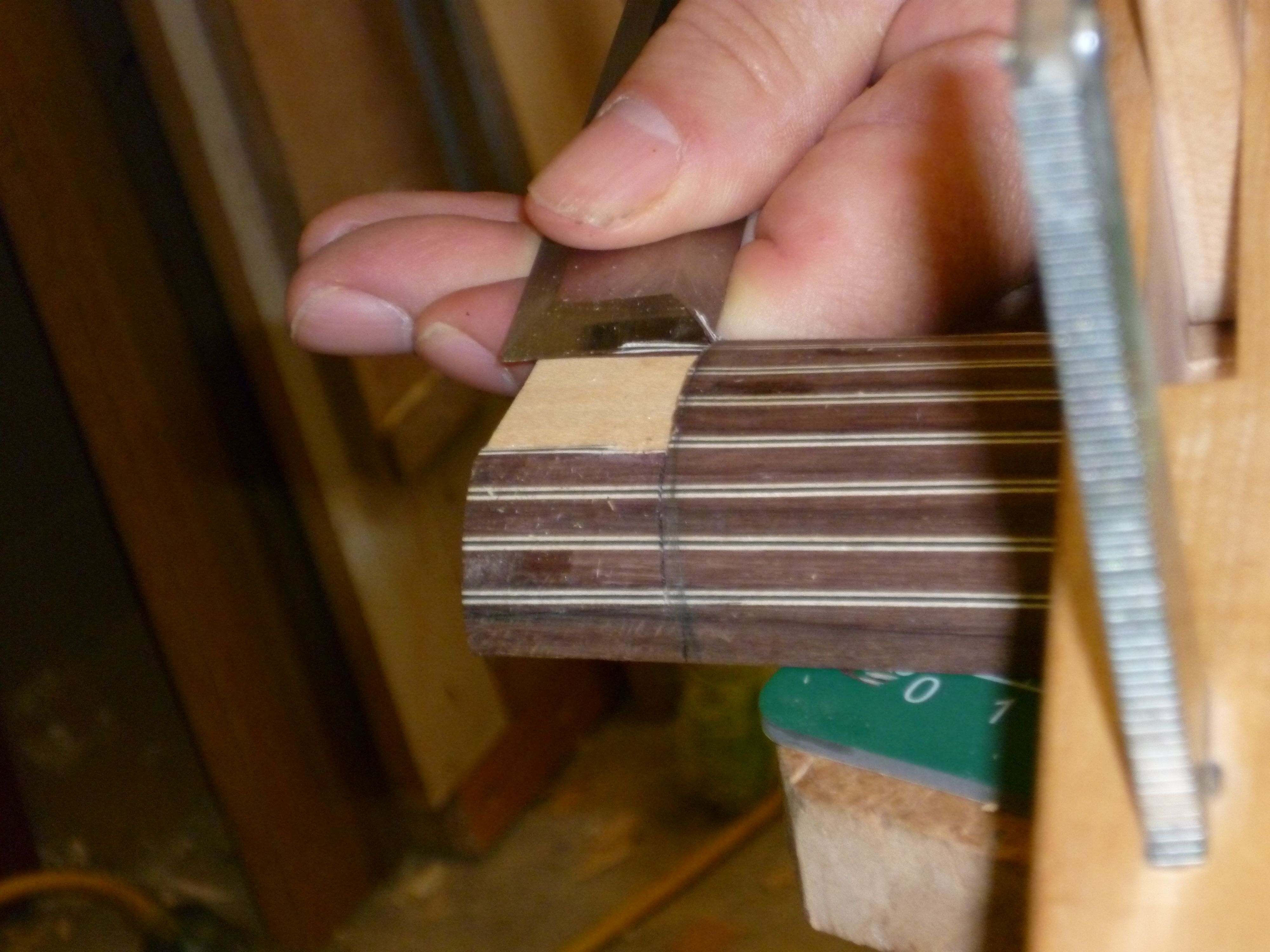

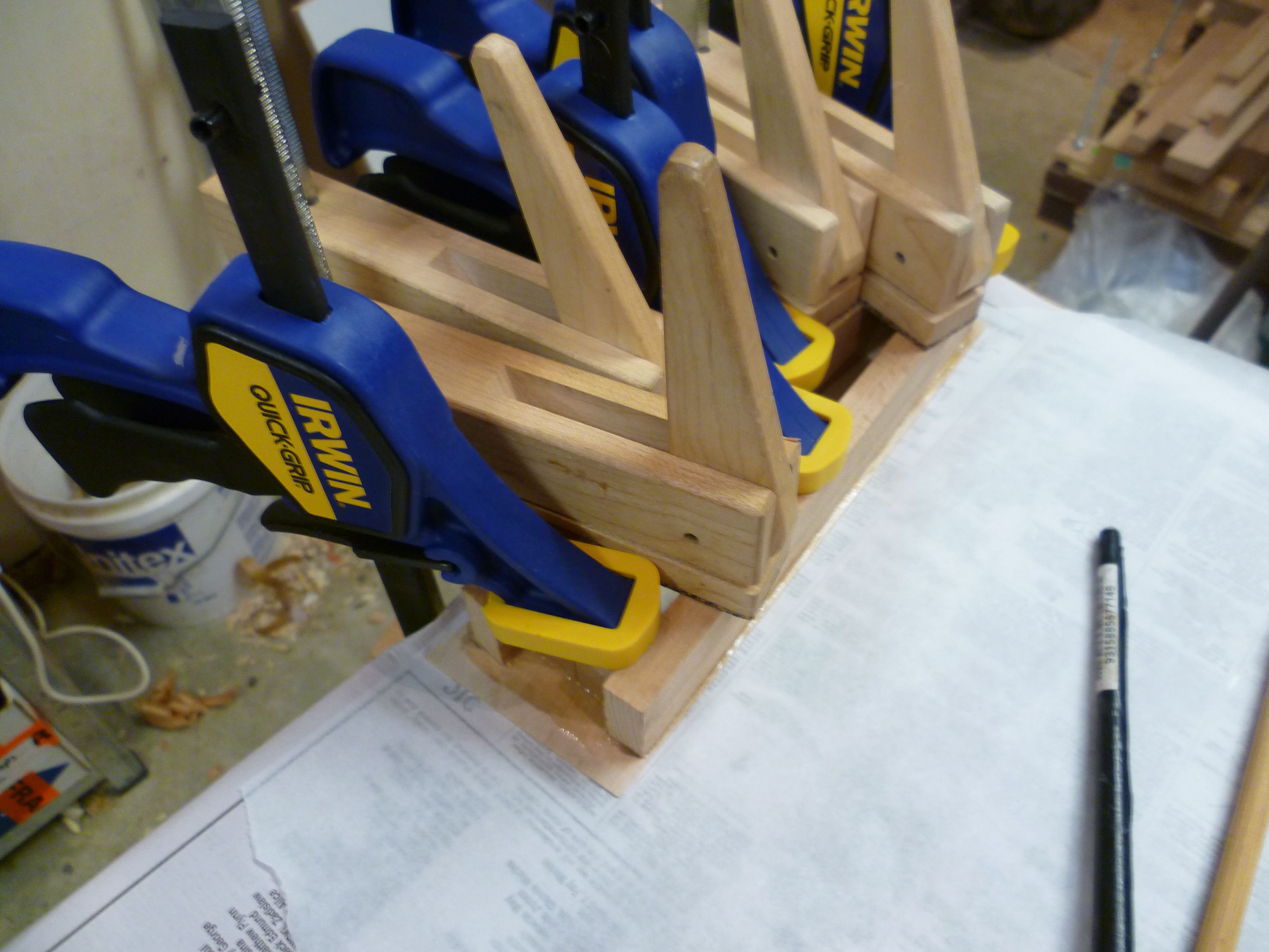

A bit more work on the lute today.....chiseled out the rebate in the neck for the peg head. The chisel is one of my work horses...a Robert Sorby 3/4" paring chisel.

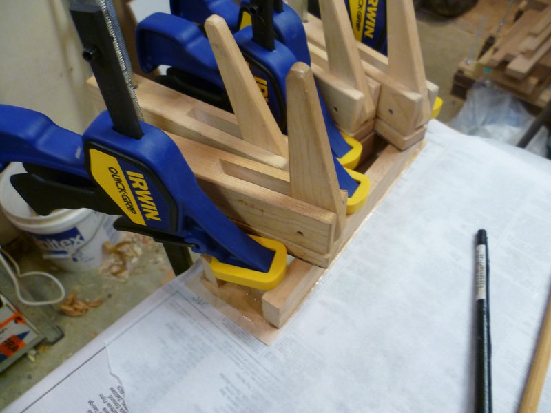

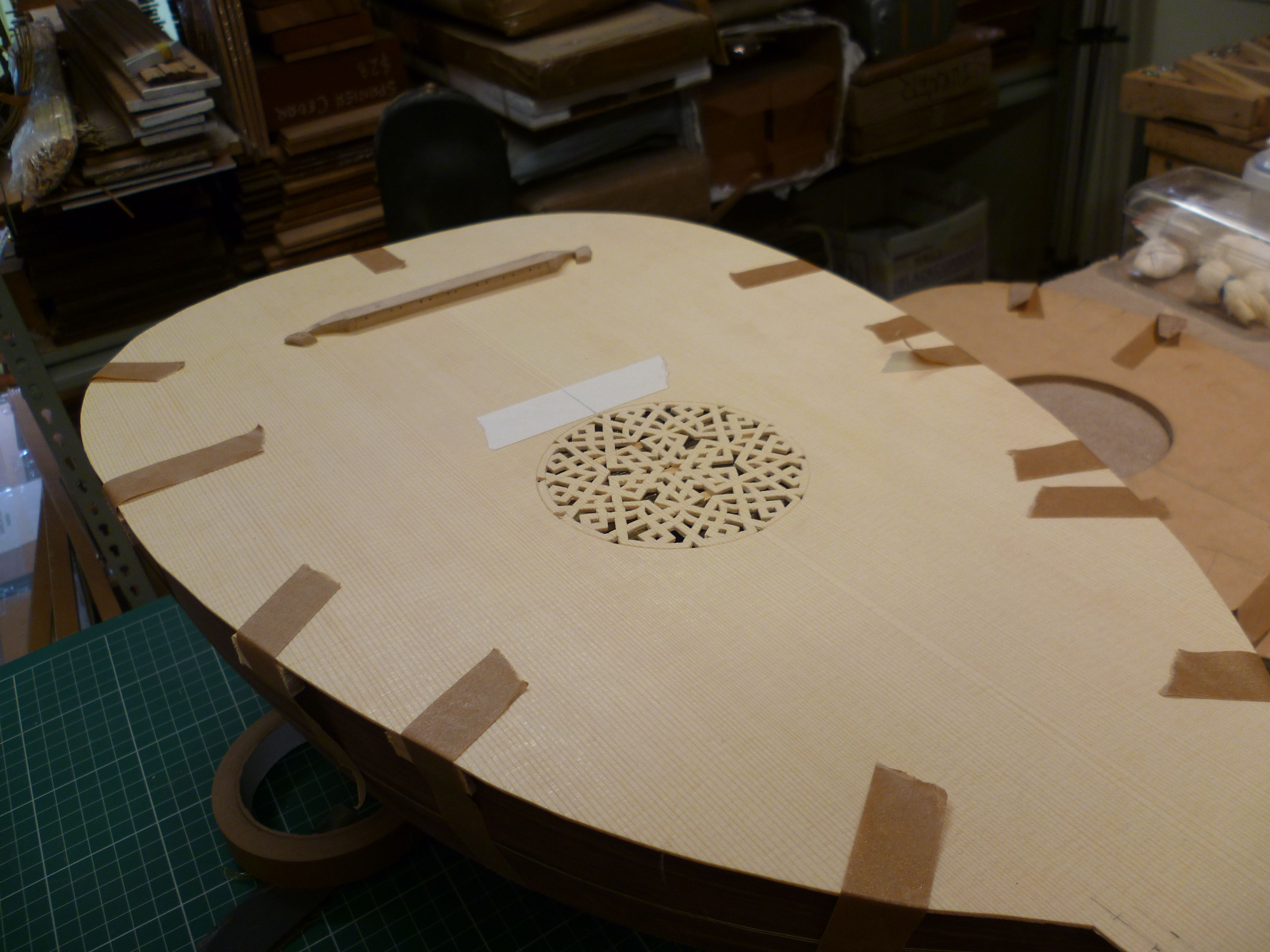

The bridge with clamps off. The bridge is slighly off centre relative to the rosette but this is common on lutes. The position of the bridge is determined by the layup of the top string (chantrelle).

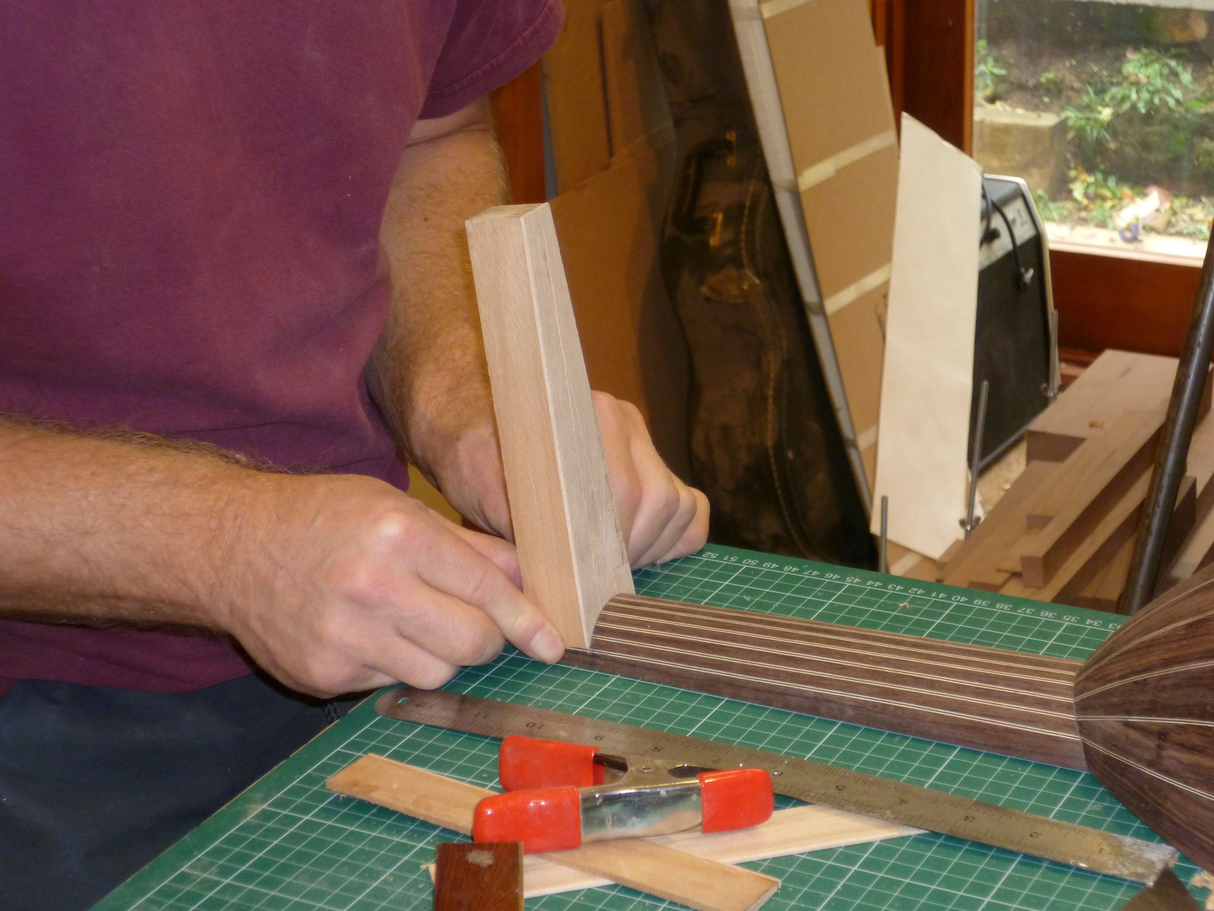

Great pictures there Martin, Iv'e spent quite a bit of time looking at them day dreaming, did the strips on the back of the neck get glued separately ? or three at a time ?

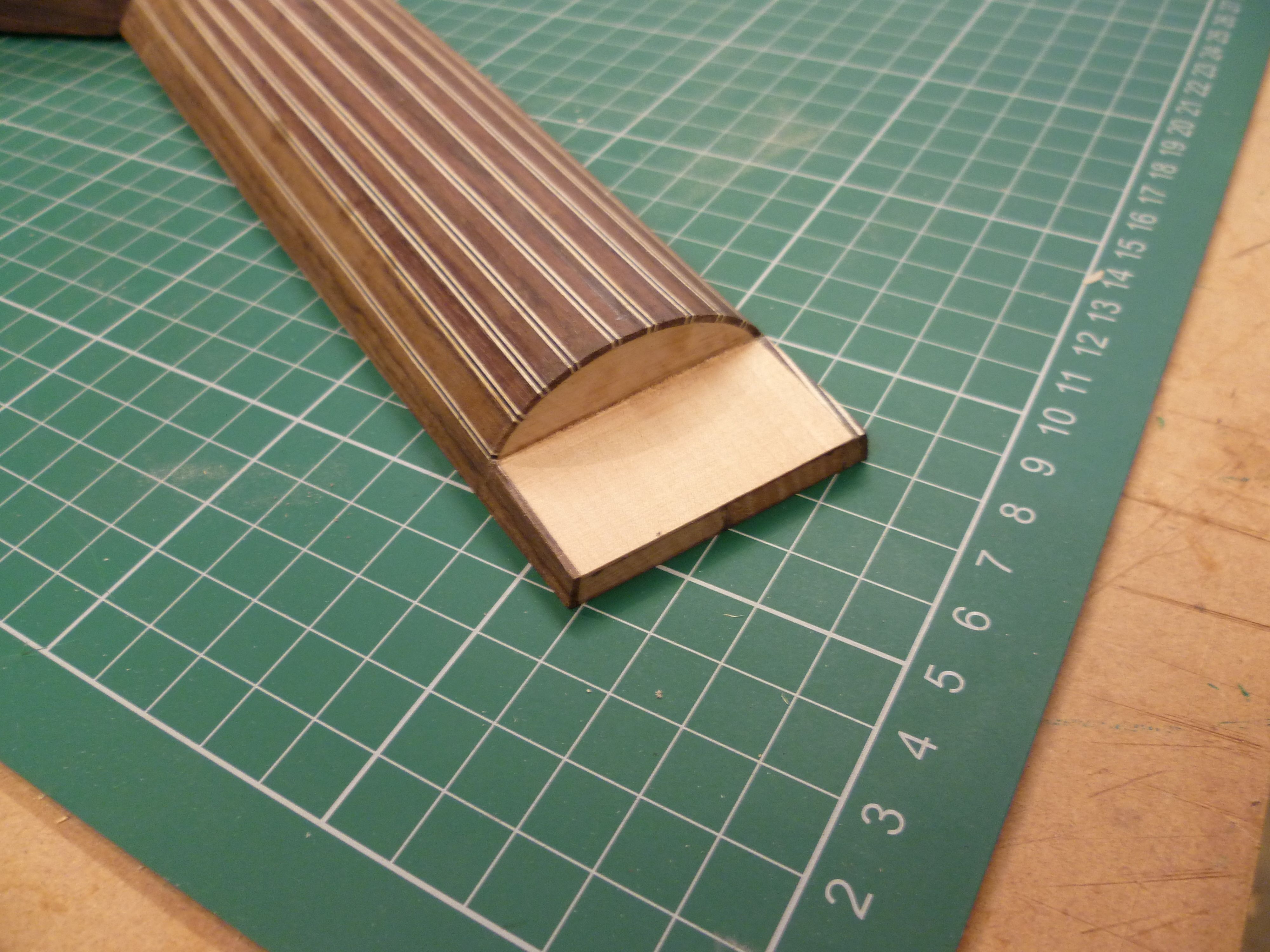

auscab wrote:Great pictures there Martin, Iv'e spent quite a bit of time looking at them day dreaming, did the strips on the back of the neck get glued separately ? or three at a time ?
cheers Rob
Hi Rob,
Started with the middle RW strip and then worked out to each side gluing up a RW strip and purfling strip with each gluing session. A tedious task getting strips on neck matched up with the body.....twice I had to go back to square one and start again with a new neck core.

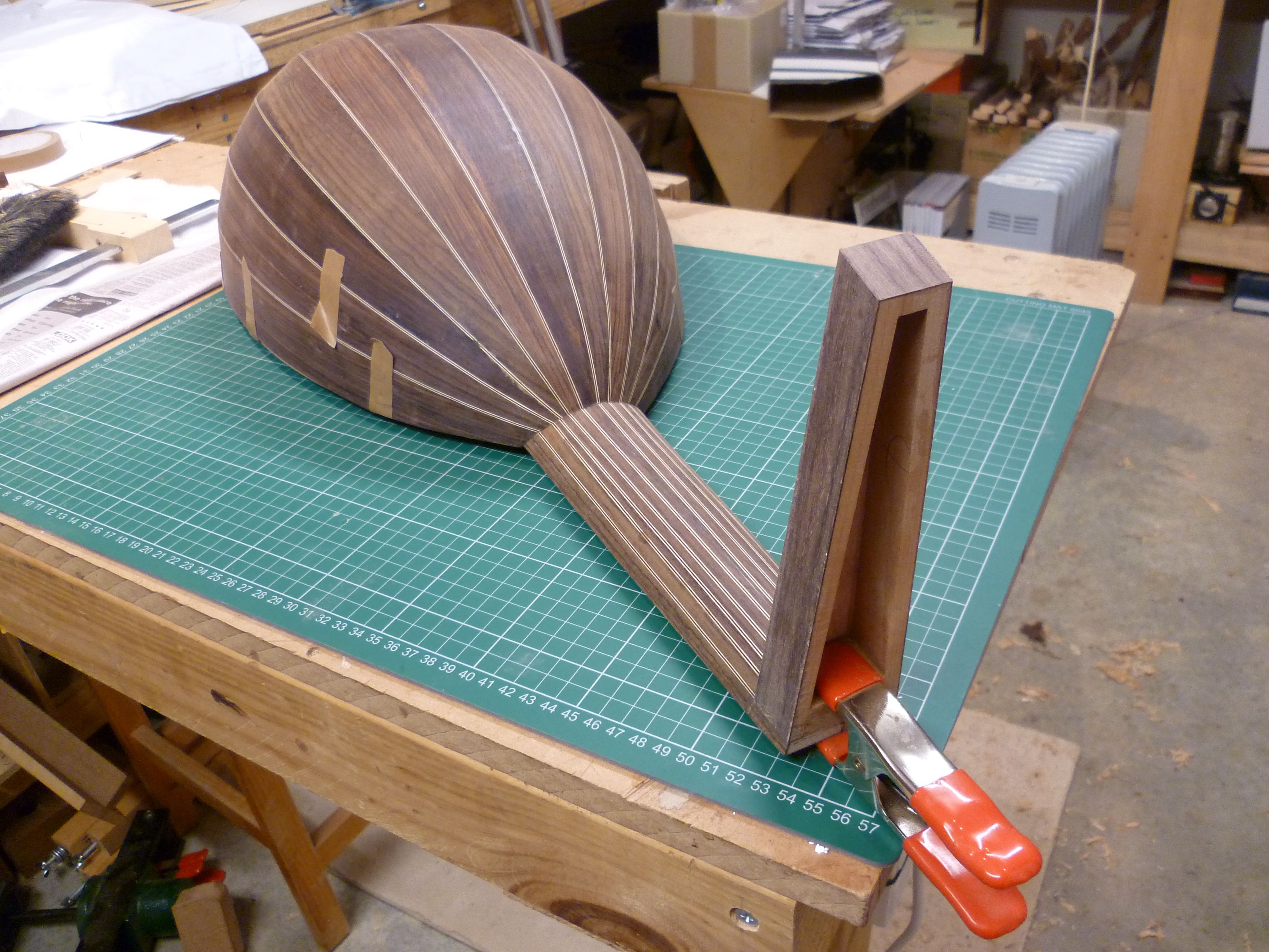

Re: Lute Progress -
Post by kiwigeo » Sat May 28, 2011 10:04 pm

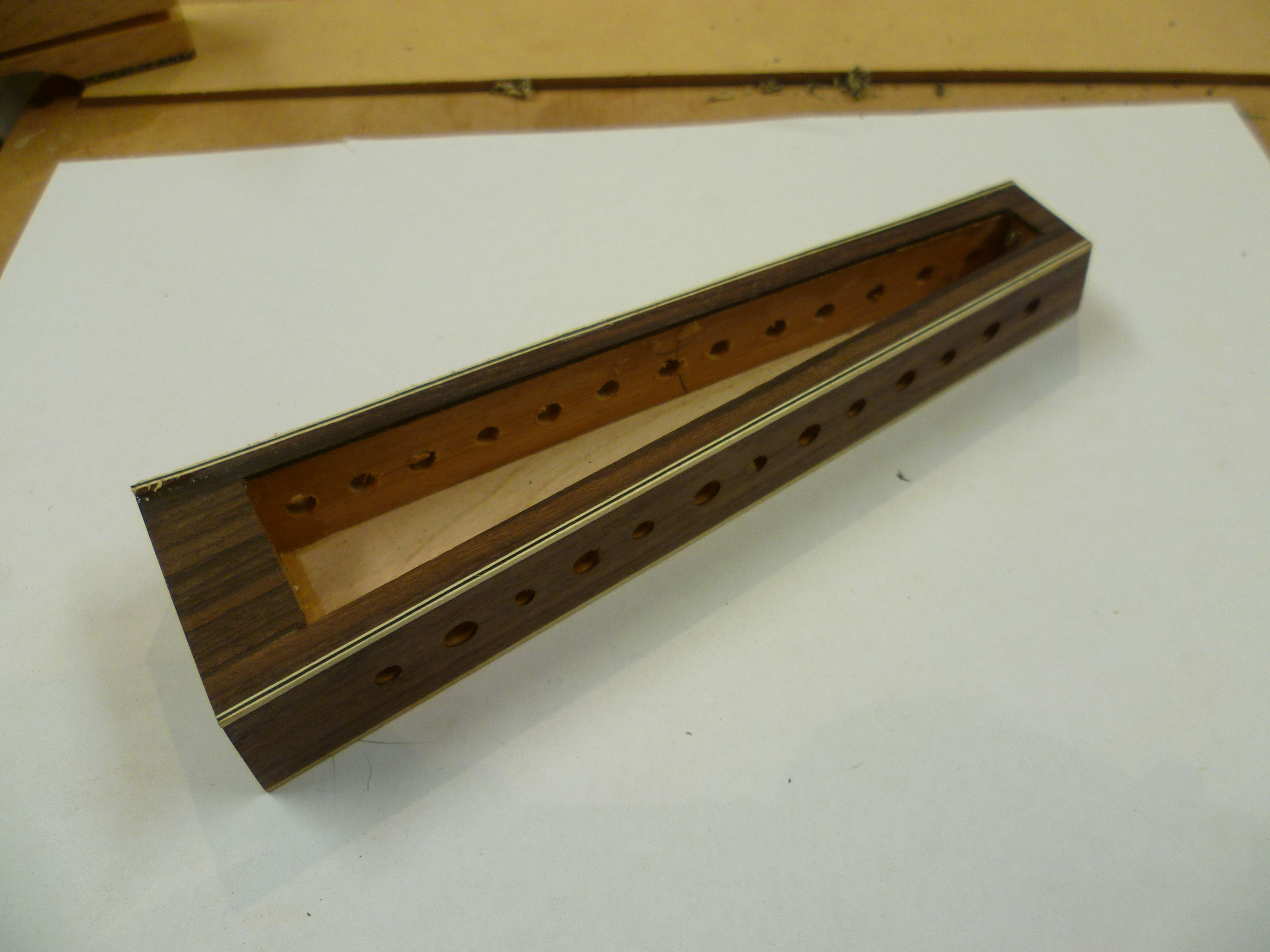

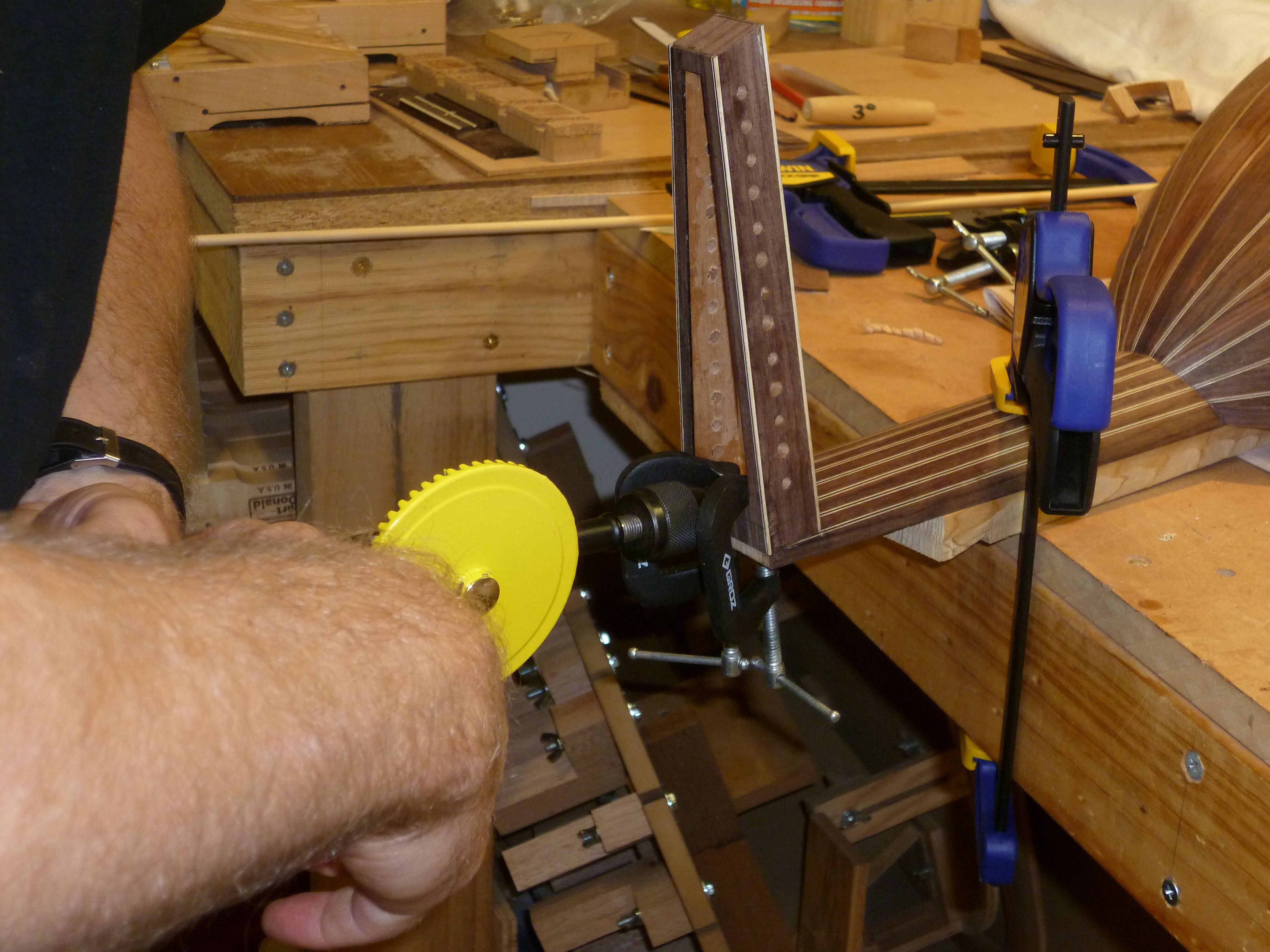

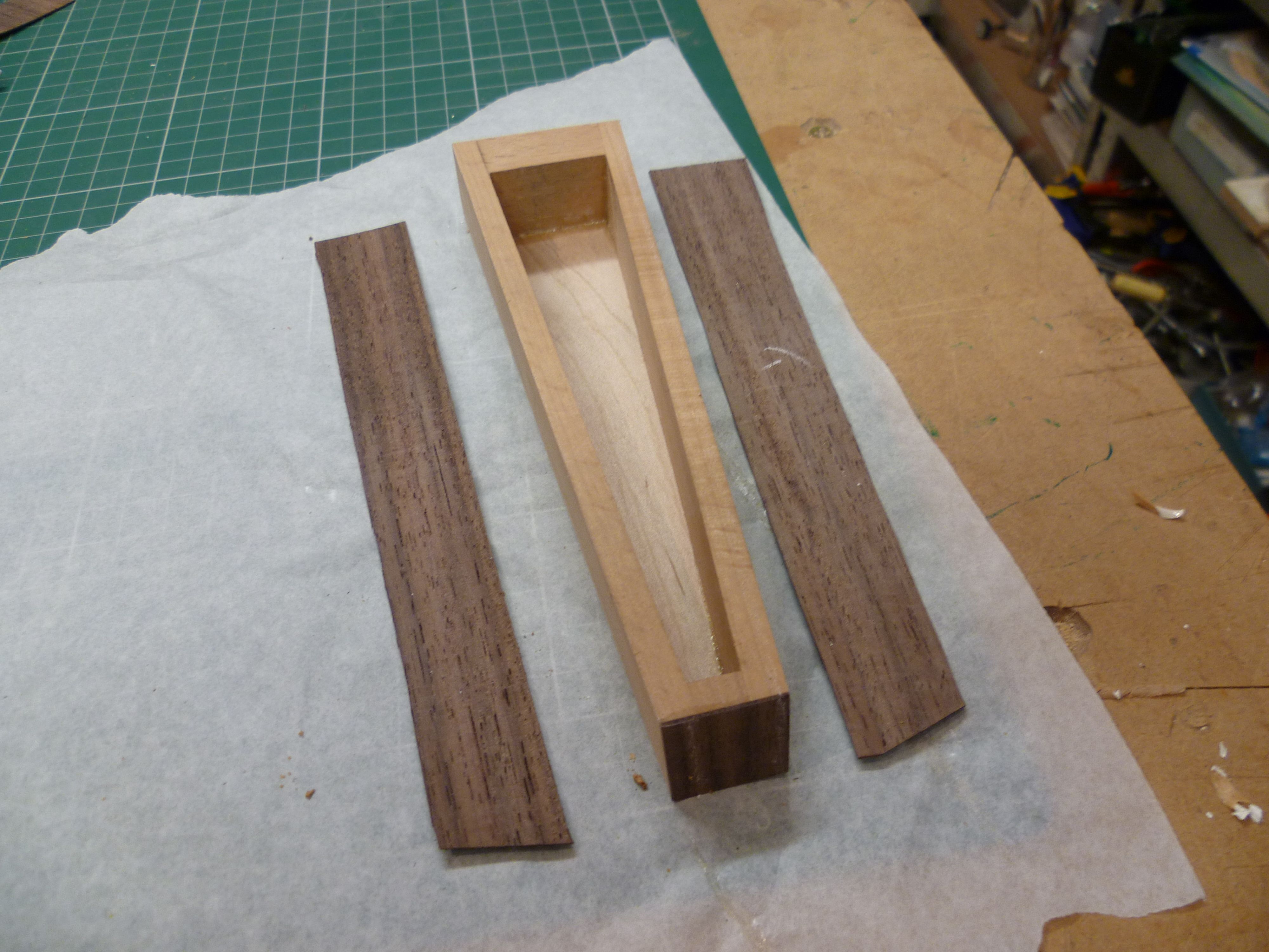

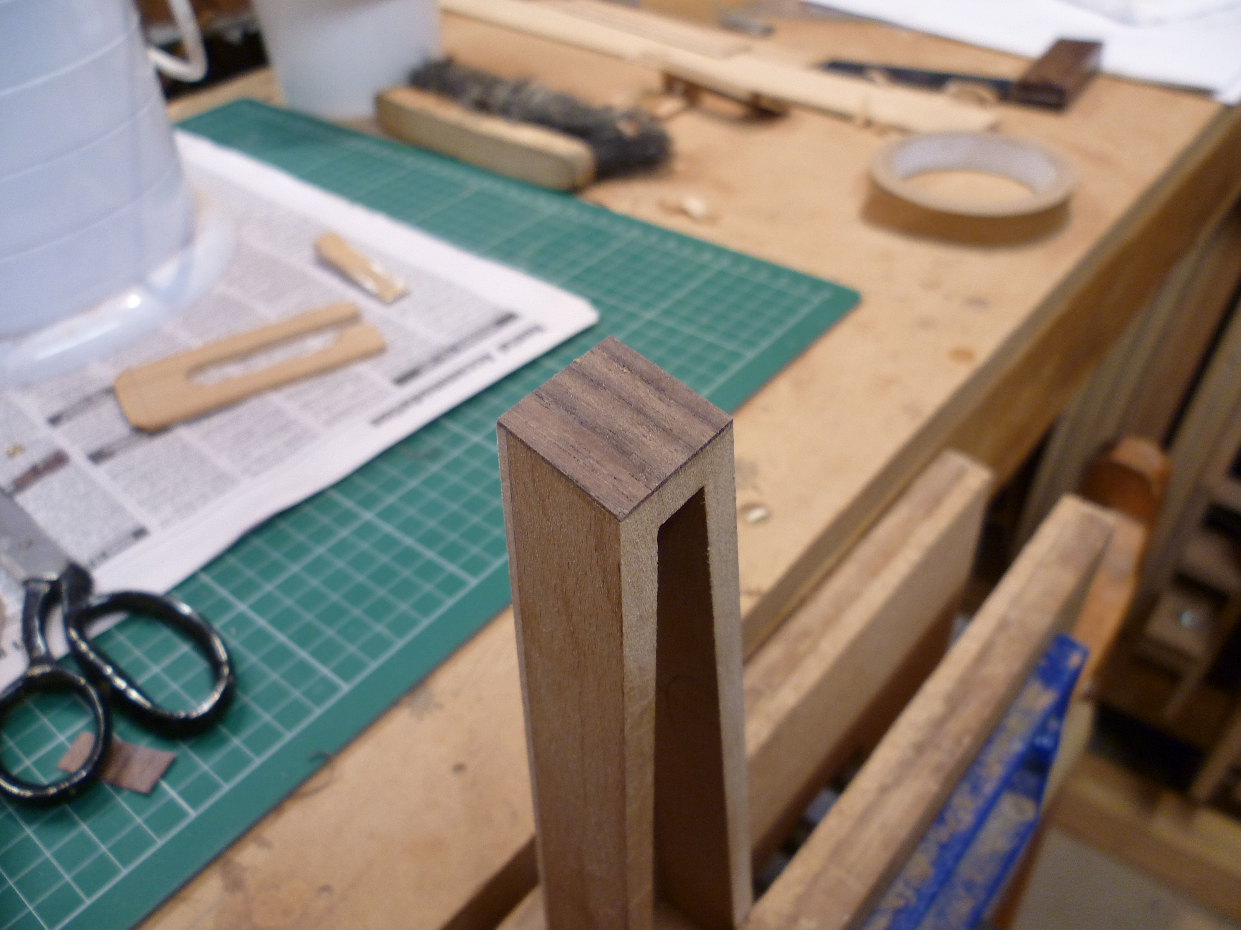

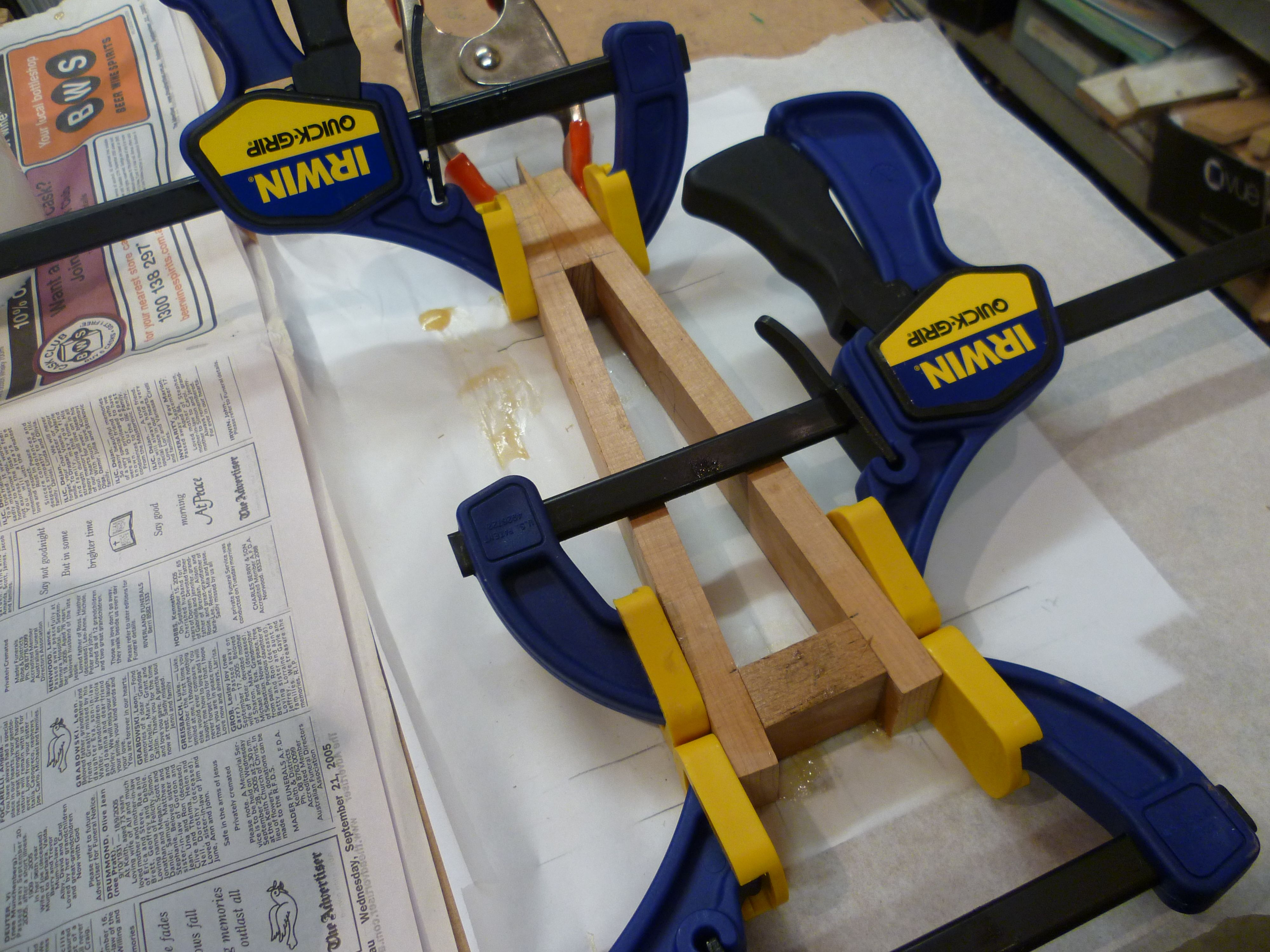

More progress on the lute. Made up the pegbox frame and got the veneers done on the sides and end of same. Next step is drilling the pilot holes for the pegs and then completing the veneering.

Re: Lute Progress -
Post by Clancy » Sun May 29, 2011 9:42 am
Does the back of the pegbox get the stripey treatment too?
Posts: 10873
Re: Lute Progress -
Post by kiwigeo » Sun May 29, 2011 10:20 am
Clancy wrote:Does the back of the pegbox get the stripey treatment too?
That very much depends on my patience and tolerance levels for failure. The veneering on the neck shaft took at least 3 attempts to get right. Unfortunately looking at the back of the neck and the back of the pegbox and bearing in mind my totally anal approach to building I dont really have much choice do I?

Re: Lute Progress -
Post by kiwigeo » Tue May 31, 2011 6:16 pm

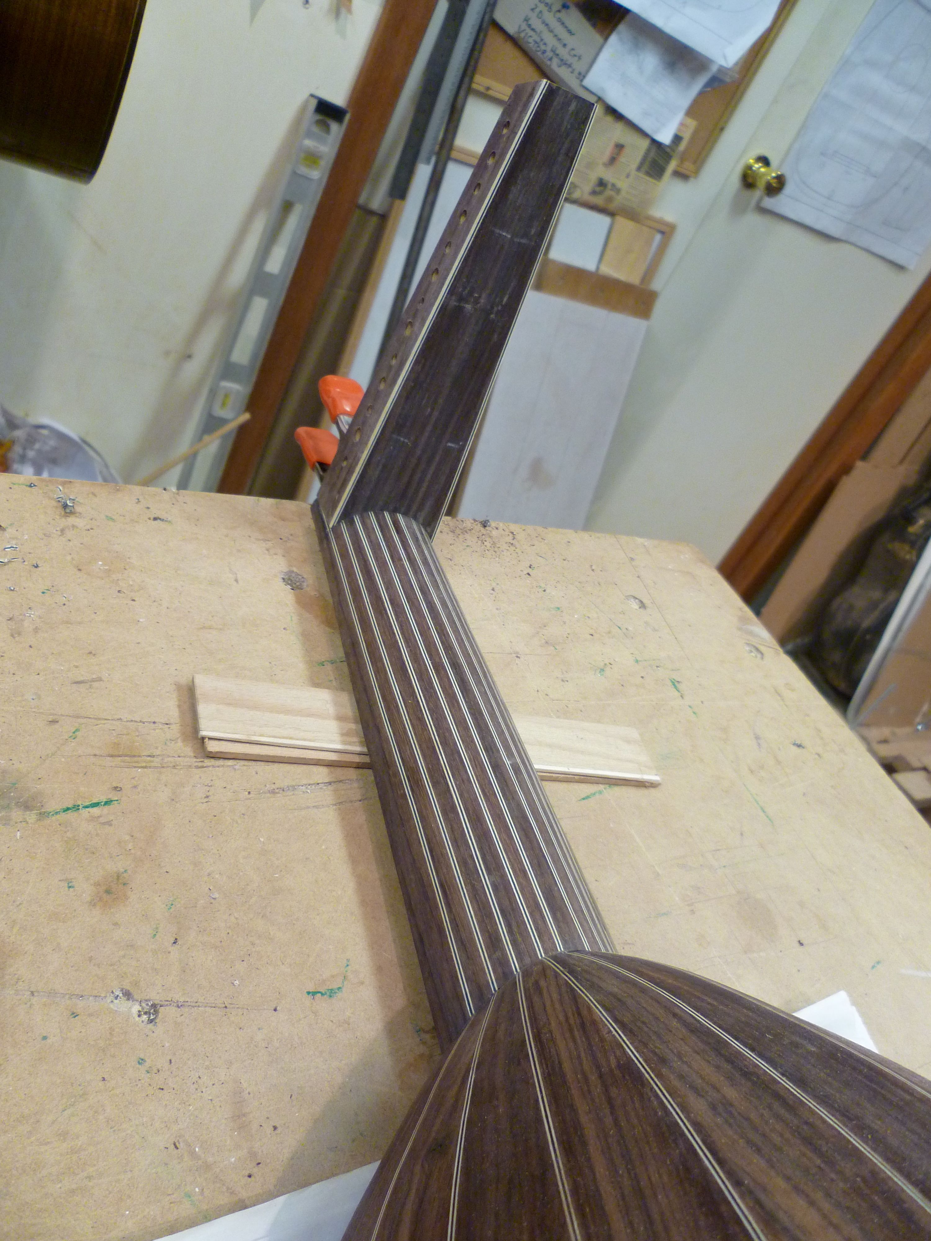

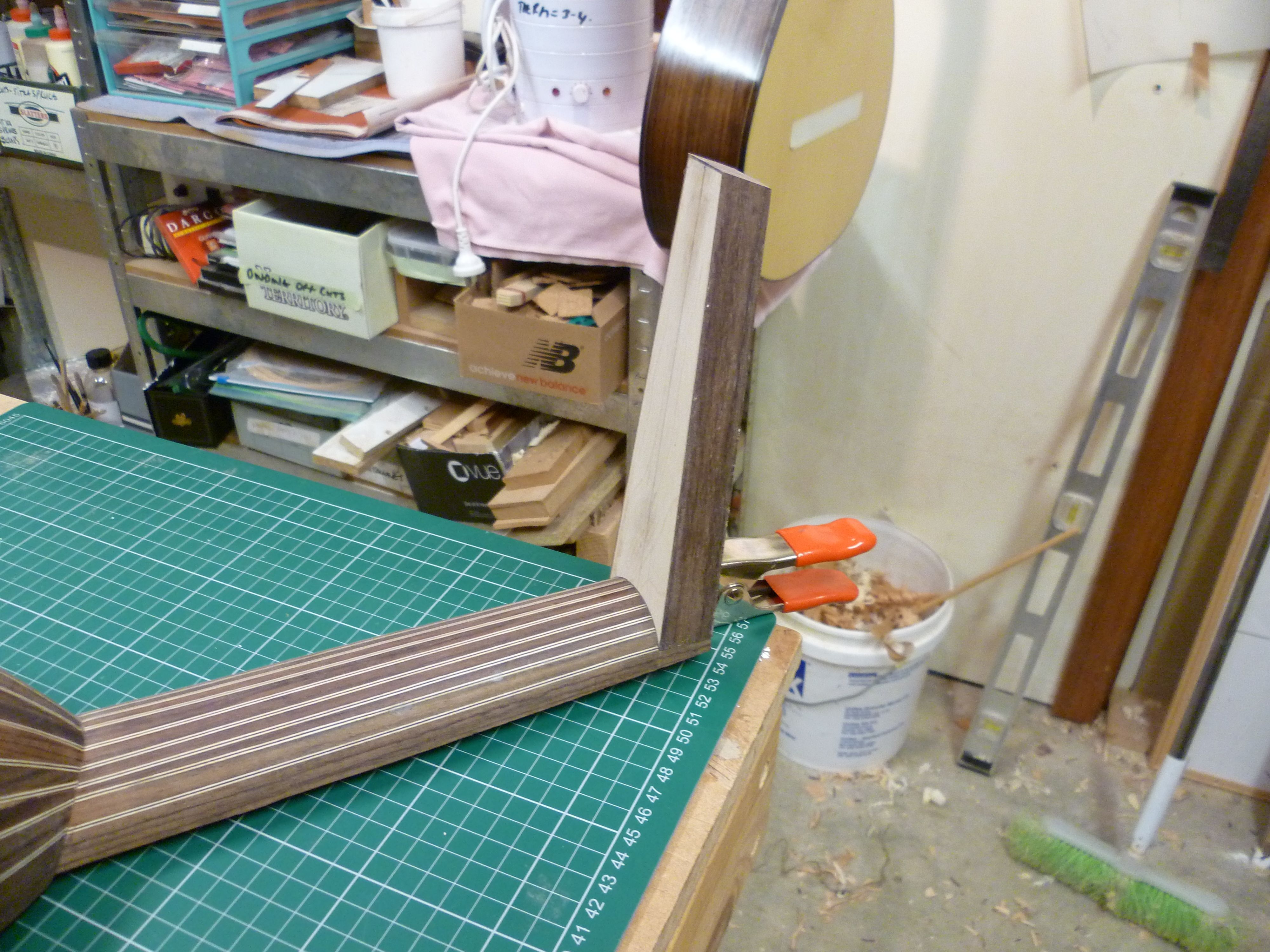

Have been doing a bit of research on how various lute makers have decorated the back of their pegboxes. I can only find one instrument where all the stripes on the neck have been carried through the back of the peghead. On some instruments the maker has carried only two or 4 of the stripes through the pegbox. What Ill probably do is carry one pair of stripes through to the pegbox. The veneer is 0.8mm thick on the pegbox of my lute so its going to be a tricky job.
Posts: 10873
Re: Lute Progress -
Post by kiwigeo » Sun Jun 05, 2011 9:41 pm
Back of the pegbox veneered. I decided to keep it simple and carry two purling strips up outer edges of pegbox back.

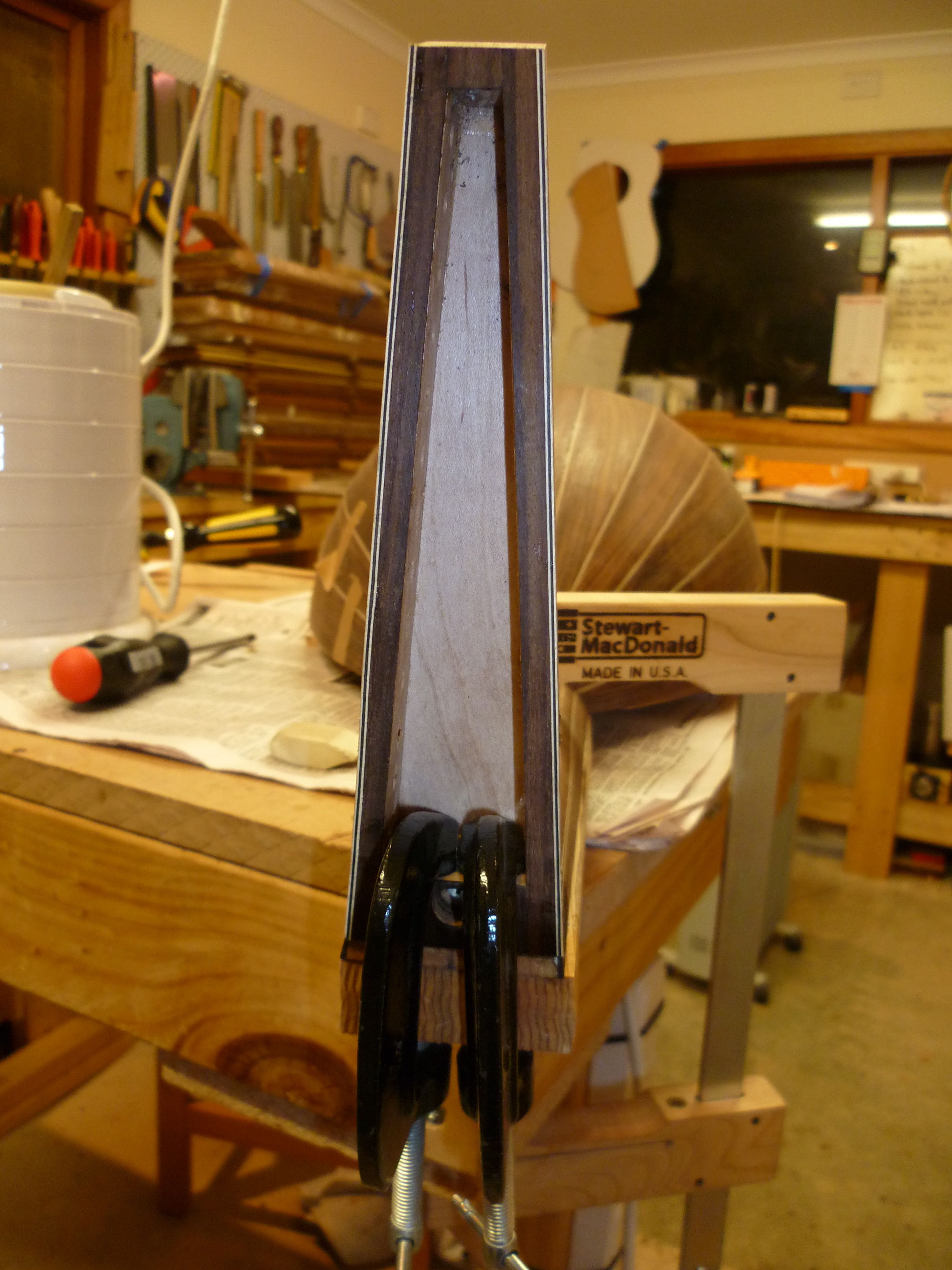

Re: Lute Progress -

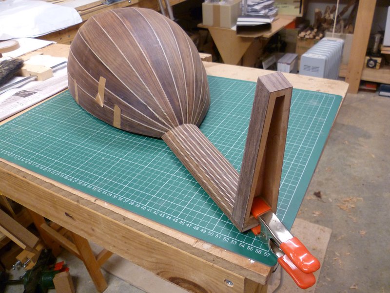

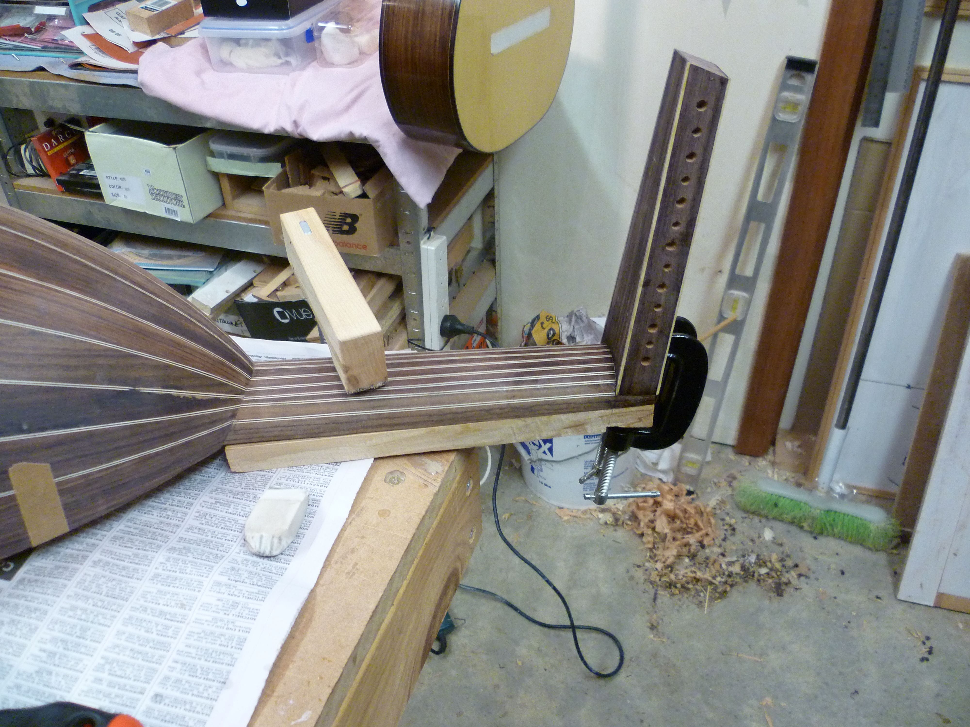

Post by kiwigeo » Tue Jun 07, 2011 9:09 pm

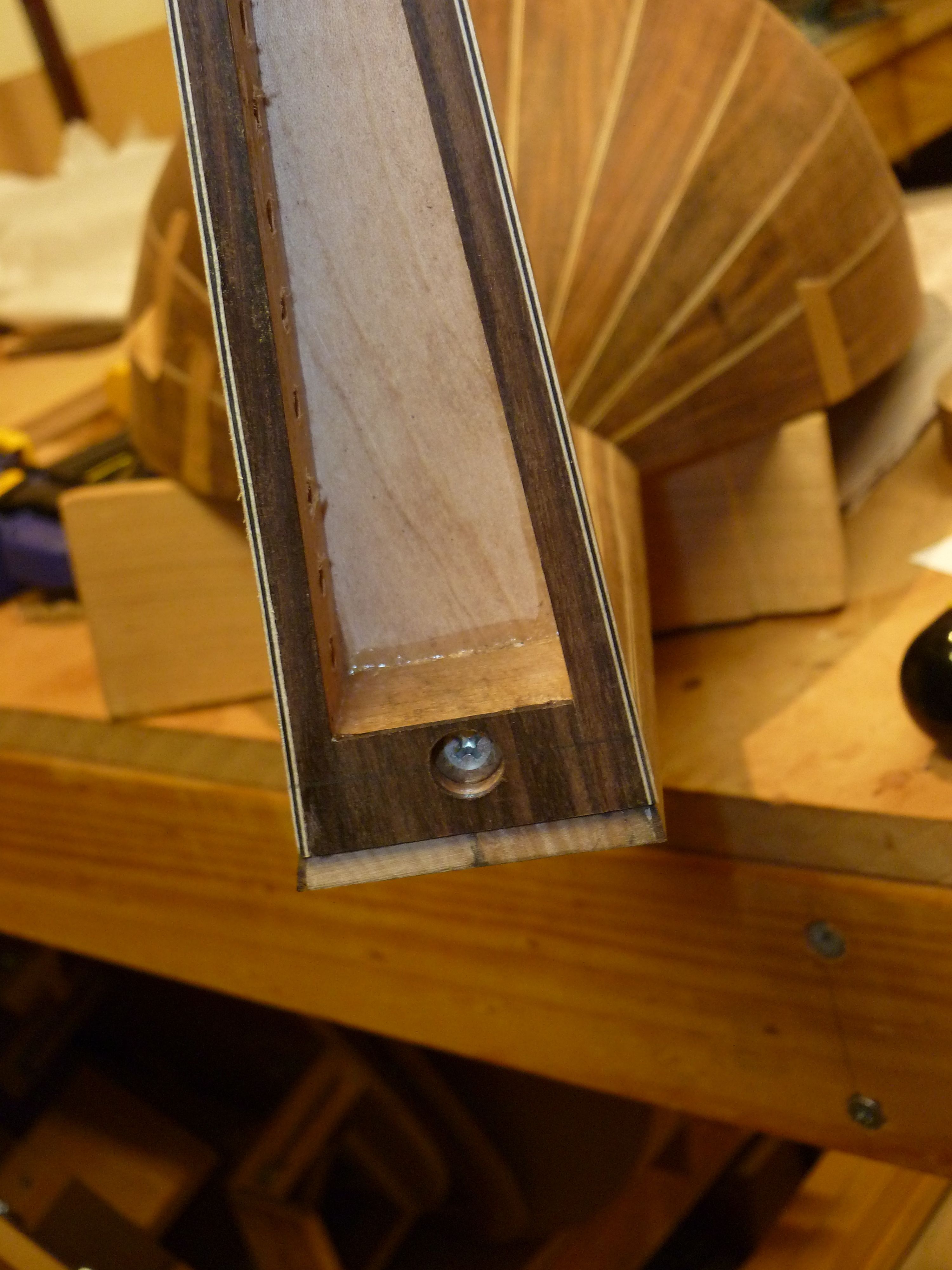

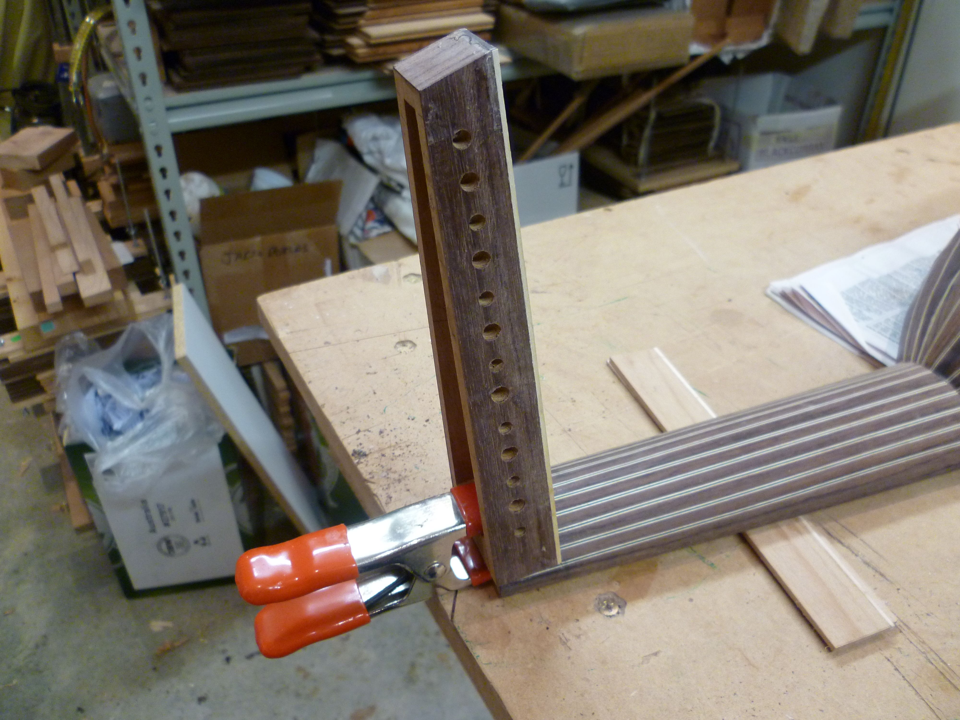

Despite spending most of the day distracted by other matters I finally managed to get the pegbox and neck mated....another major milestone on this build. I was of two minds regarding the screw through the pegbox into the neck but ended up doing it purely as insurance.

Re: Lute Progress -
Post by Allen » Tue Jun 07, 2011 9:51 pm
I like the way that just a couple of purfling lines continue on to the peg box. All of them would be away too much, and none would look unfinished.

I see the peg holes are drilled, will you be using modern tapers or the slightly narrower old
pitch?
Tom.

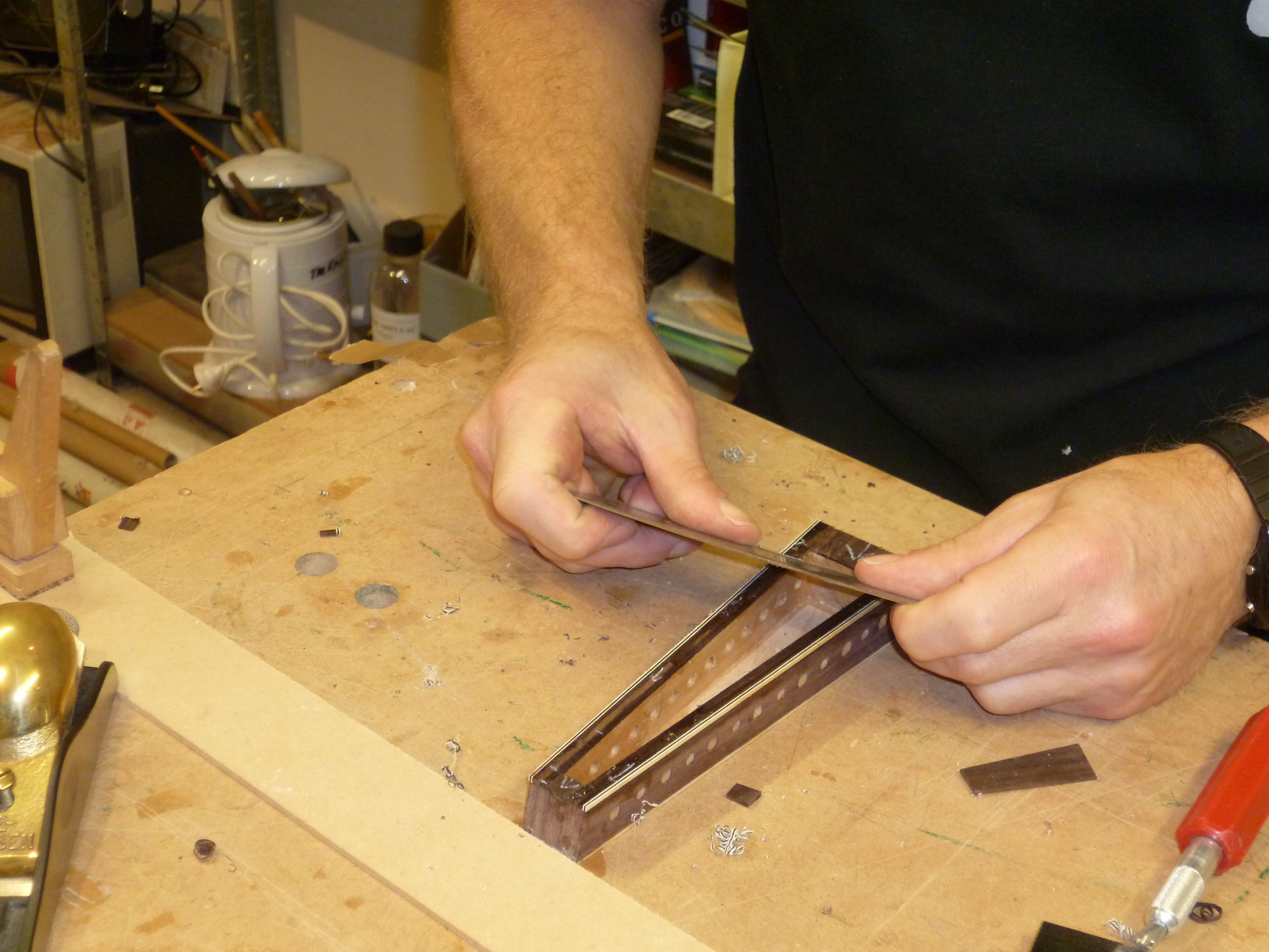

Posts: 10873
Re: Lute Progress -
Post by kiwigeo » Tue Jun 07, 2011 10:12 pm
TKAY wrote:Thanks for the progress pics ,it is certainly inspiring a fair few to greater things.
pitch?
Tom.
Hi Tom,
Peg holes are plot holes only and have been rough reamed with a 1/30 taper reamer. Ill stick with this taper for the final fit of the pegs.
