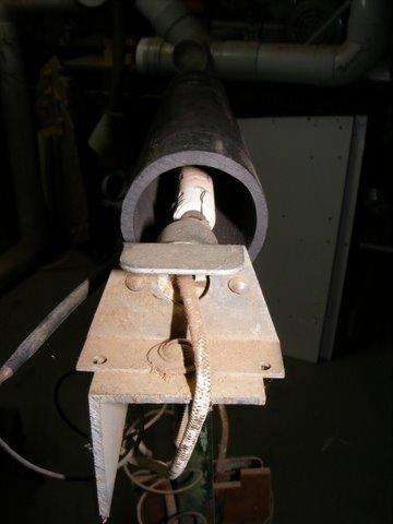

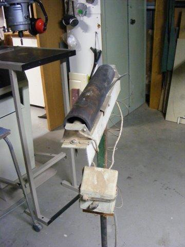

My second attempt at this post.
Just pics this time
DSCF5122 (Small).JPG (34.63 KiB) Viewed 19442 times
DSCF5124 (Small).JPG (24.92 KiB) Viewed 19442 times

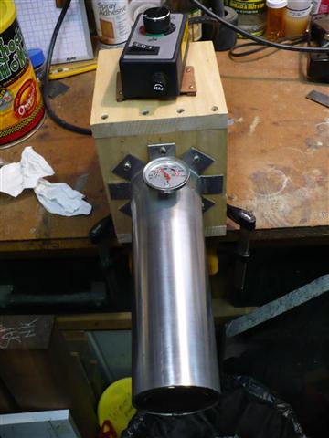

I made one with replacement truck tail pipe section, inserted an electric charcoal starter and plugged it into a router speed controller, popped in a grill thermometer, and it works great. Can't post pics yet - post count, I assume.
P1010574 (Large) (Small).JPG (35.21 KiB) Viewed 19404 times
It was a size thing. The forum doesn't accept standard sizes if the size happens to be taller than it is wide, even though the numbers are still within the parameters.

The picture [above] of the iron I have used, and I have one larger, I have used since 1975, or so. Both have coiled heating elements from a room radiator and controllable oven thermostats that sets the heat where I like it. I also have safety protection on the power system too.
